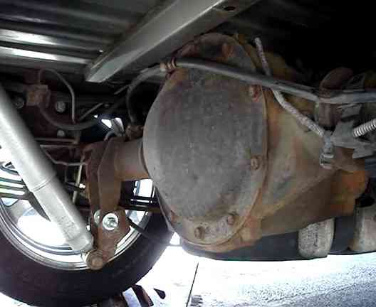

yes still looking for help to fix this problem

the kit is # 2110 western chassis, 2004 silverado 2wd rcsb
sorry there upside down only had a magnet mount for my camera

Realize you didn't have the problem before you dropped it but it sounds like endplay in pinion. Pull the driveshaft and check by stroking yoke on rearend.
For piece of mind I would replace u-joints. Check tranny mounts have seen these bolts come loose before. I would make sure those shock extensions aren't moving, maybe tack them in place if have welder.

Gap between leafs is excessive, something isn't right there.
Attached Thumbnails flip installed but has issues?-th_mov06806_zps4ea01b19.jpg
