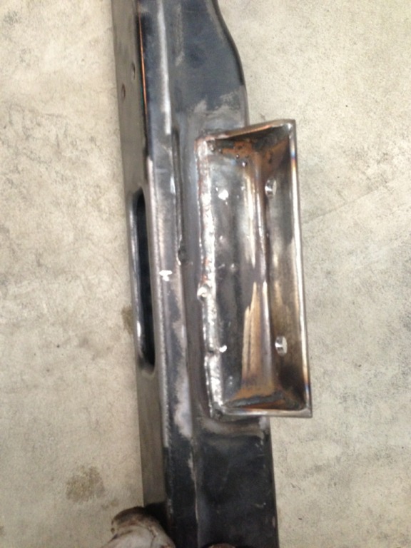

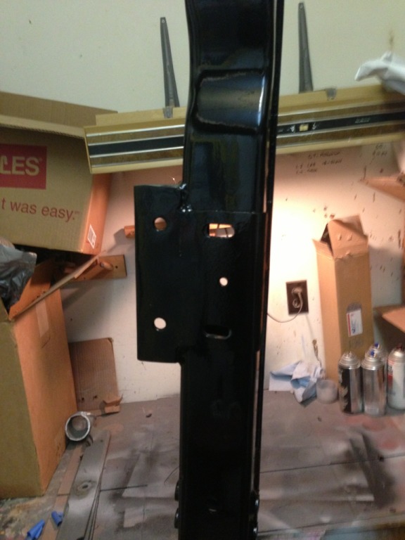

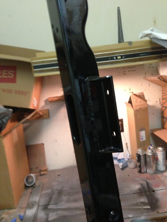

Old Mar 25, 2013 | 08:01 AM
  #364
03sierraslt's Avatar
Posts: 19,007
Likes: 221
From: Western PA
More crossmember pics.

That looks great pat. How long before you do the swap? I'm going to order my new converter very soon. I'll get my swap done shortly after that.
Old Mar 25, 2013 | 12:39 PM
  #366
Posts: 19,007
Likes: 221
From: Western PA
Waiting on my billet input shaft then trans will be done, next month or so I guess. Waiting for weather to break before I get the truck back out.
