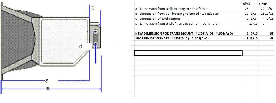

This is what I've come up with for DS length and cross member modification. Lucky (or unlucky) enough to have an extra 65E laying around. Everything I've found on the net says the 60E should be 21.75 long. I've measured mine 3 times at 22 3/8.
Need to move the crossmember mount back about 2.5 inches. The DS shortened about 1.75 inches.

Holy **** this is beyond informative. Great job so far Roger.

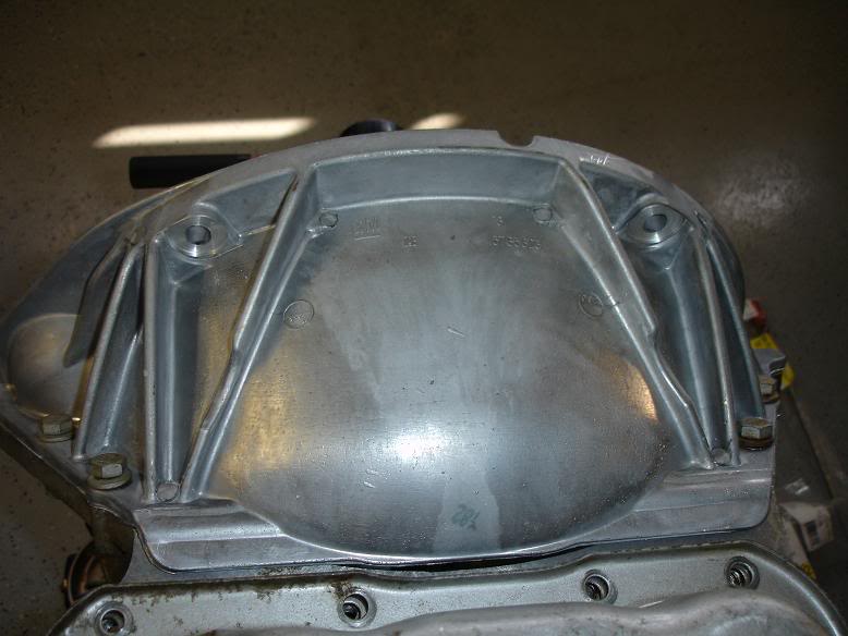

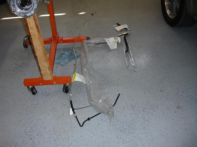

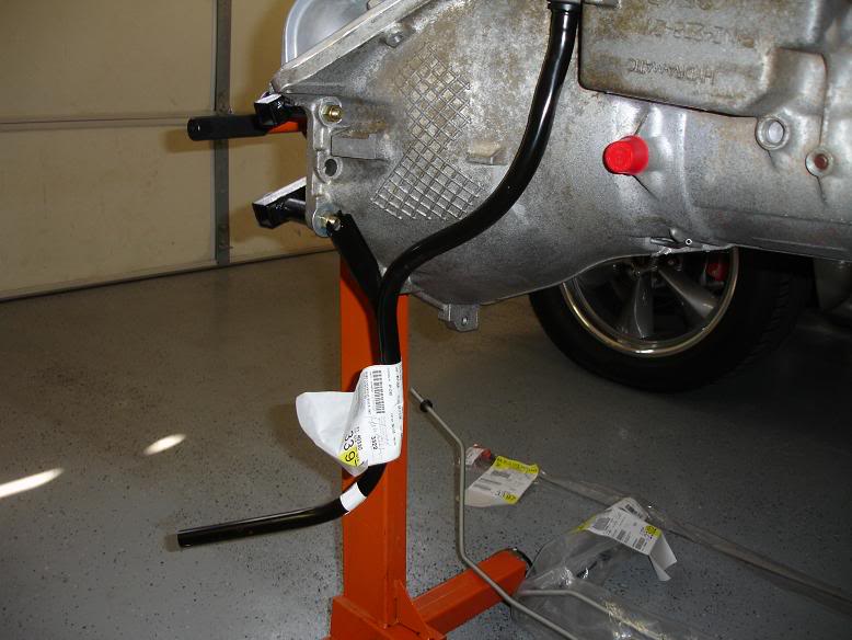

Ordered these parts from the dealer Monday. Most arrived today. Still a couple out. Unknow if they work installed but look right.
15809057 Hose - part of the trans cooler lines
15812029 Pipe - trans cooler hard line
15267484 Pipe - trans cooler hard line
15765623 Cover - bellhousing
15013290 Bracket - shifter cable
15832205 Tube - dip stick tube
15183801 Indicator - dip stick
15860239 Bracket - heat shield / exhaust hanger passenger side
Total $267.98 with tax.

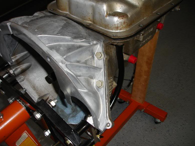

I crawled under a couple trucks to check this. The transmission has tapped holes for 3 bolts on center connection but the pans don't have the holes in them... must have been some cost saving idea?

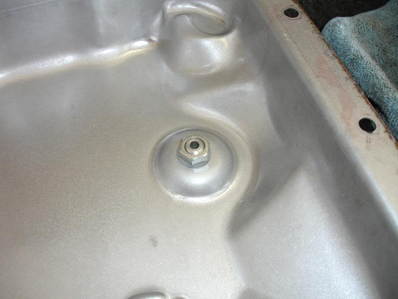

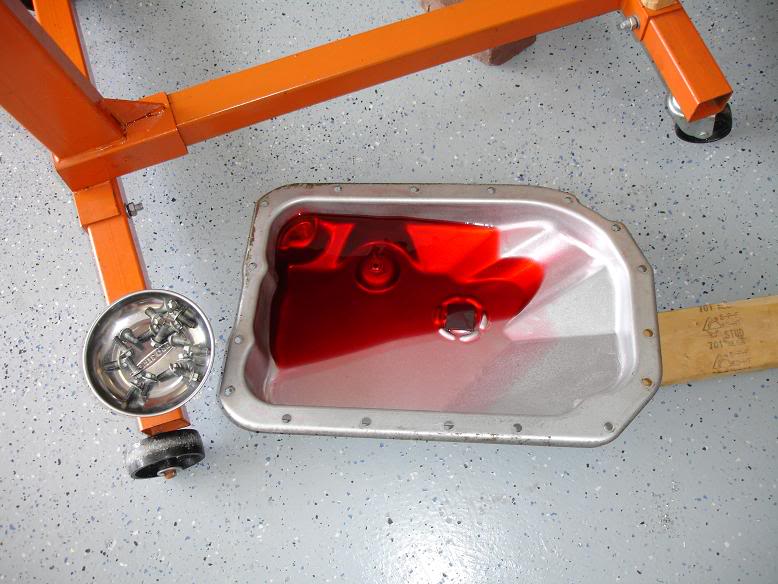

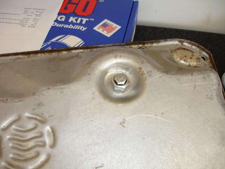

All transmission pans should have a drain plug. This one didn't so Iinstalled one of the screw in ones.
To make sure it doesn't leak before I install it. It will sit like this over night.
