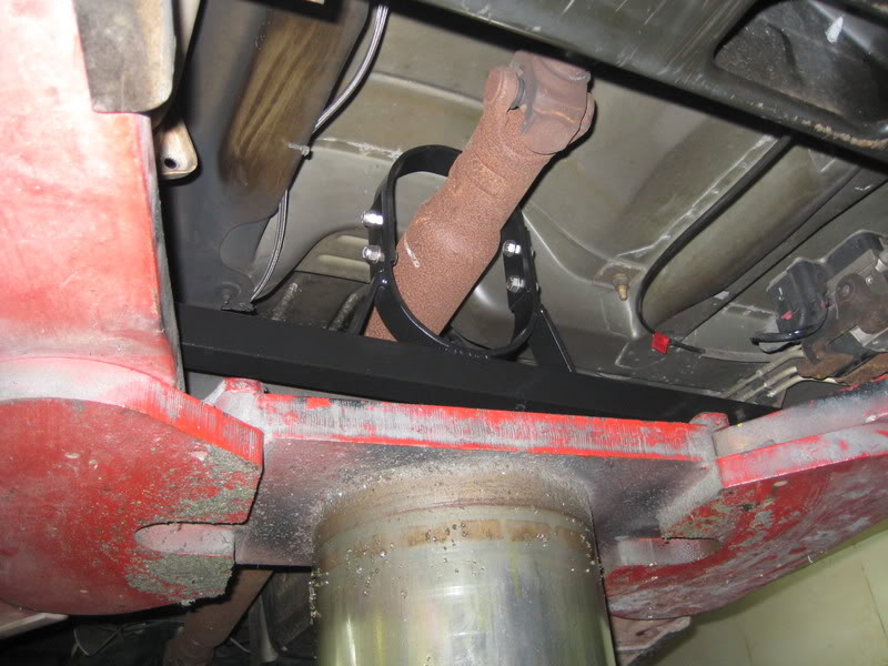

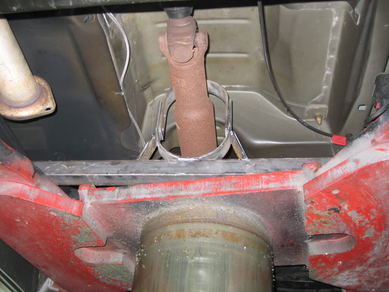

Here is the loop I made up, so they would be similar to this.. IIRC there is 2 holes on each side of the frame rails that this is bolted to( been a little while since I been under the truck)
I also have one in the rear, but it is welded to the frame of the truck.. The fuel tank was a issue for me also...
let me know if your serious..

The rear would have to be welded on not bolted on atleast the way i ahve mine.. The fron set I will ponder up a price..
