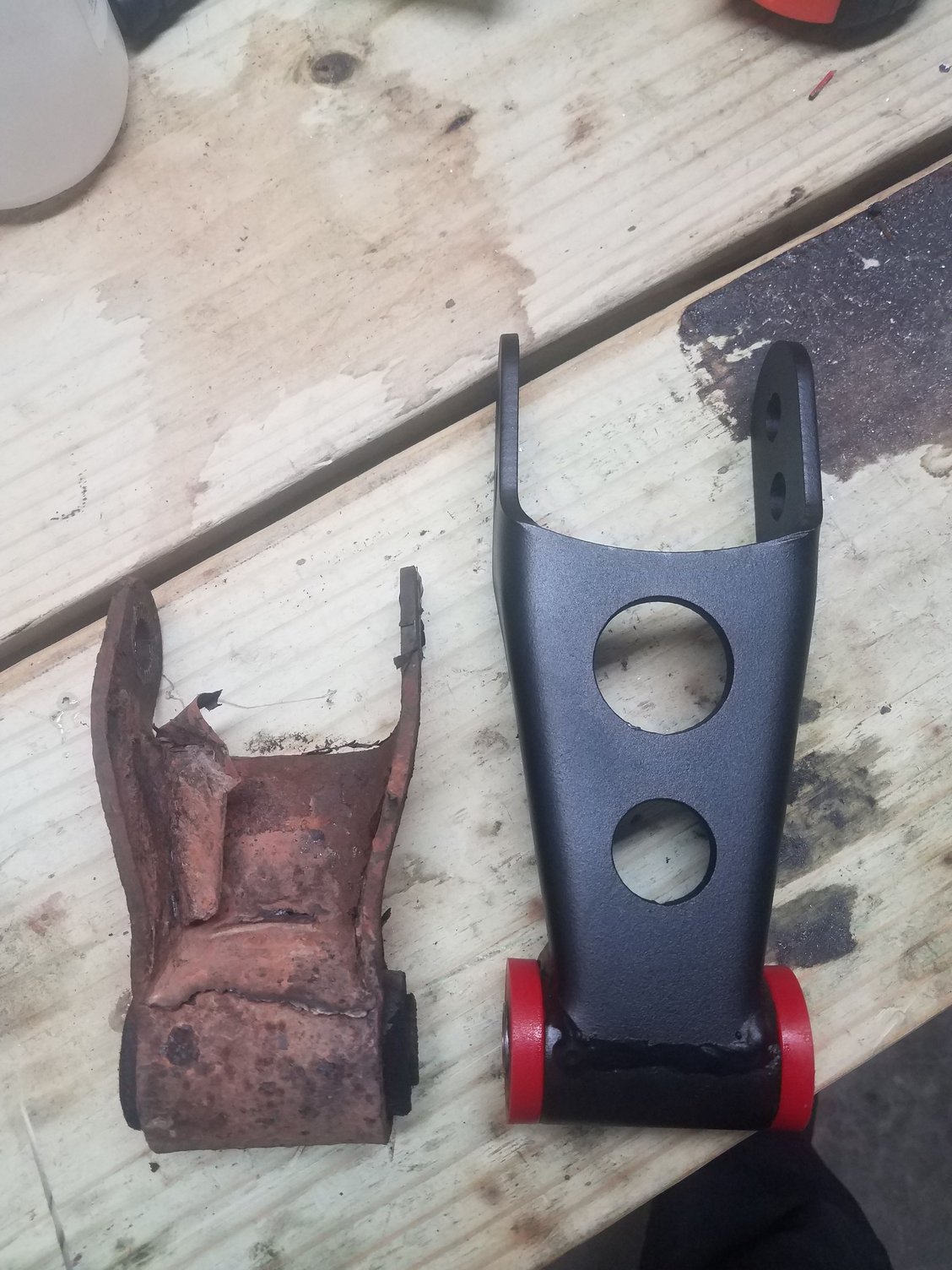

Most GMT800 trucks sit lower on the driver side due to gas tank and driver weight. When I did my coil over conversion I was able to even the front side to side but the driver rear has always sagged even with brand new leaf spring packs.
I picked up a set of DJM lowering shackles new off craigslist today and decided to see if I could get the passenger side down. So now with a lowering shackle on the passenger side and factory on the driver side the rear sits almost dead even from the ground to top of wheel well at 38in.
Is there any downside to running 2 different shackle lengths?

No issues.
Thats one of the ways to combat that issue.

another way is to trim the coil spring.

I ran offset shackles for like 8 years. my truck sat level an noticed no issues at all

one inch corrected it
