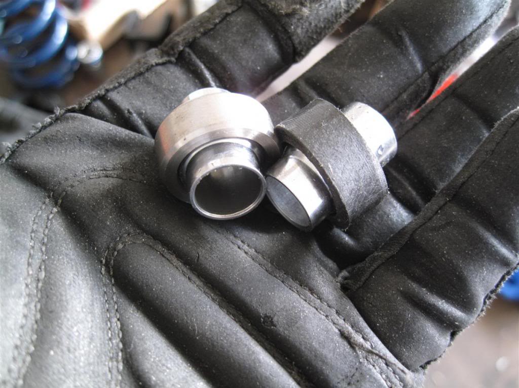

Originally Posted by Atomic
The default bearings are not steel, they are nylon. You want the bearing COM8T-102pk
Gotcha... I'll order the steel bearings asap. Shocks shipped out and should be here the 8th so should have pictures posted then.
As far as 2wd and 4wd go mounts are exactly the same.

Yea...this is what happens to the normal bearings after about 5 minutes and is why complete steel bearings are mandatory.
Comparison:
