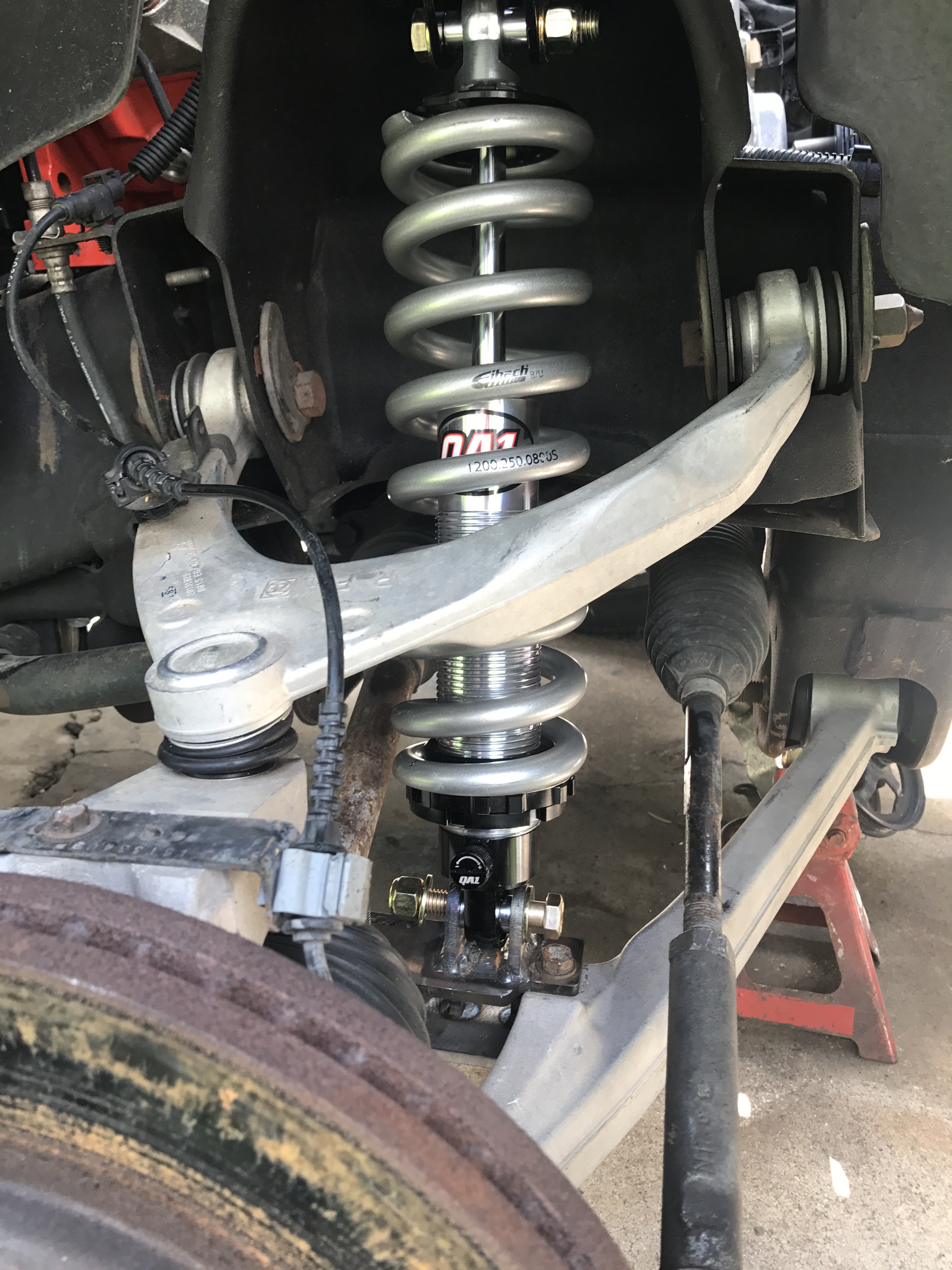

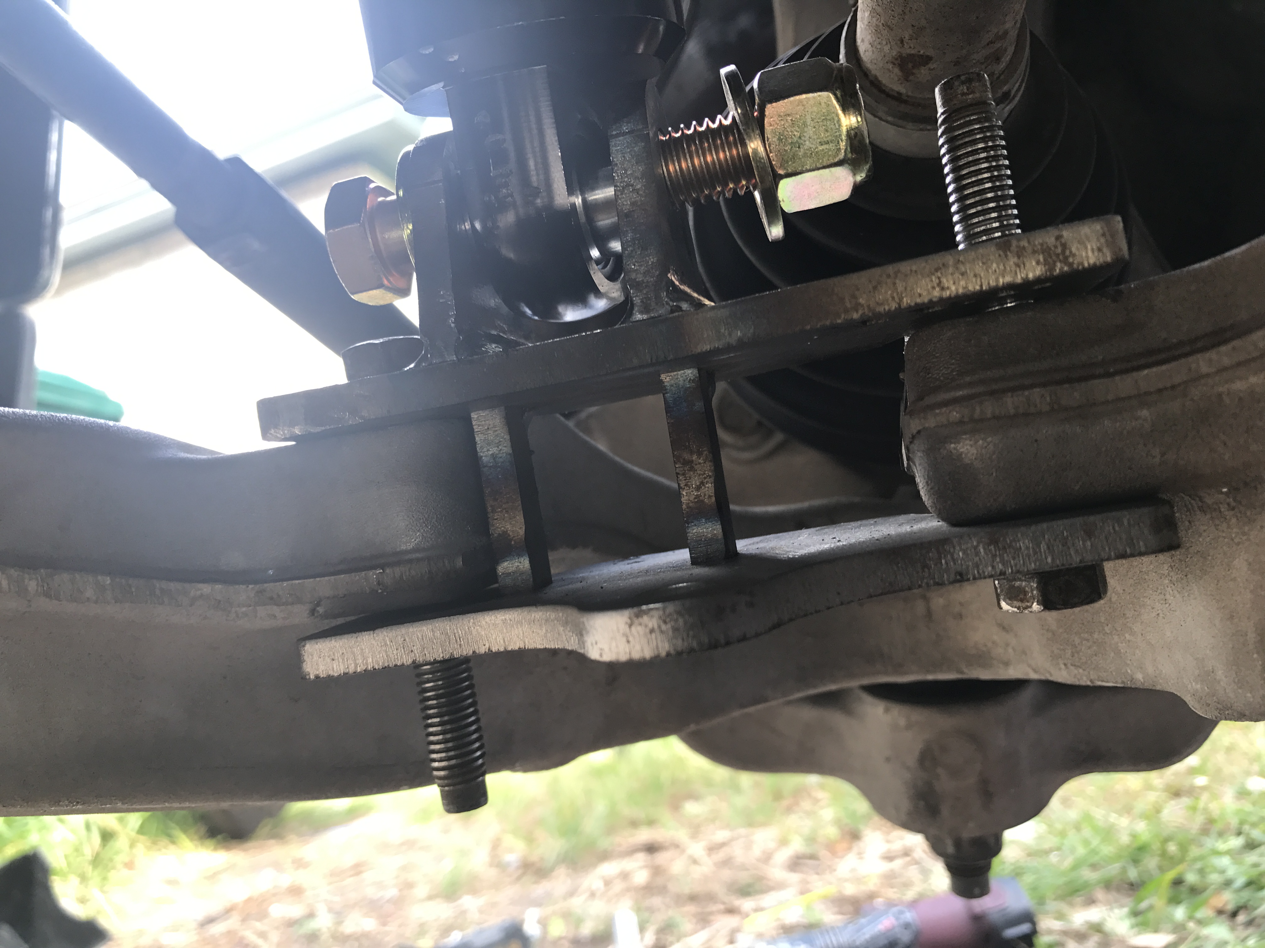

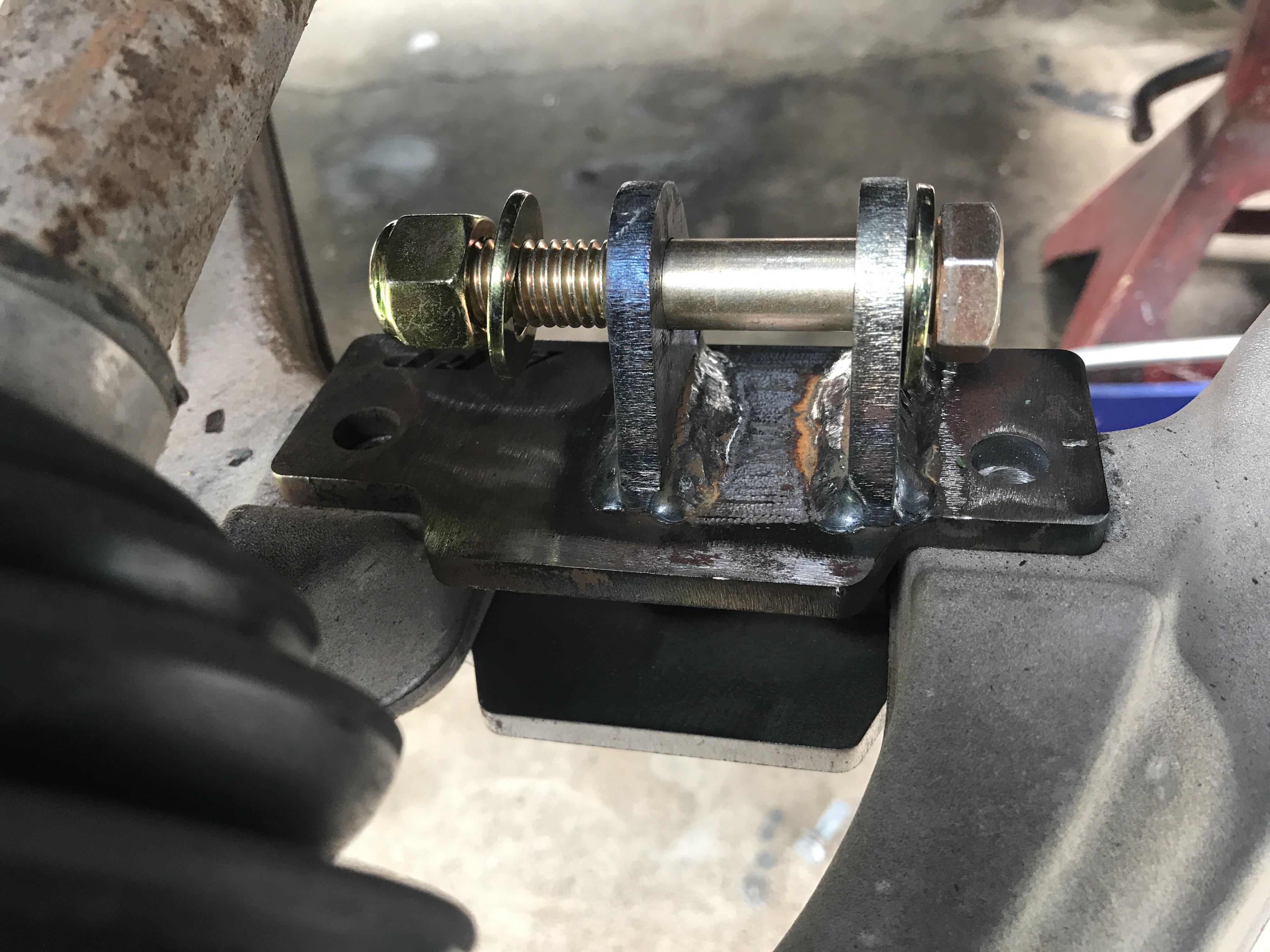

Here are some pictures of mine test fitted FINALLY. Suspension still needs to settle but should match the rear just fine. Also the 800lb spring rate on a 12" spring seems to be the magic number for my truck. On the 2wds the lower bracket won't be needed, you can run a 5" lower T-Bar mount and be fine. Mine being 4wd had to run Atomics bracket to space the coilover away from the CV shaft to give it more clearance... Overall fit and finish is great can't wait to start testing once the new setup is done.

Looks great! Thanks for being my tester, just be sure to get them painted/coated
