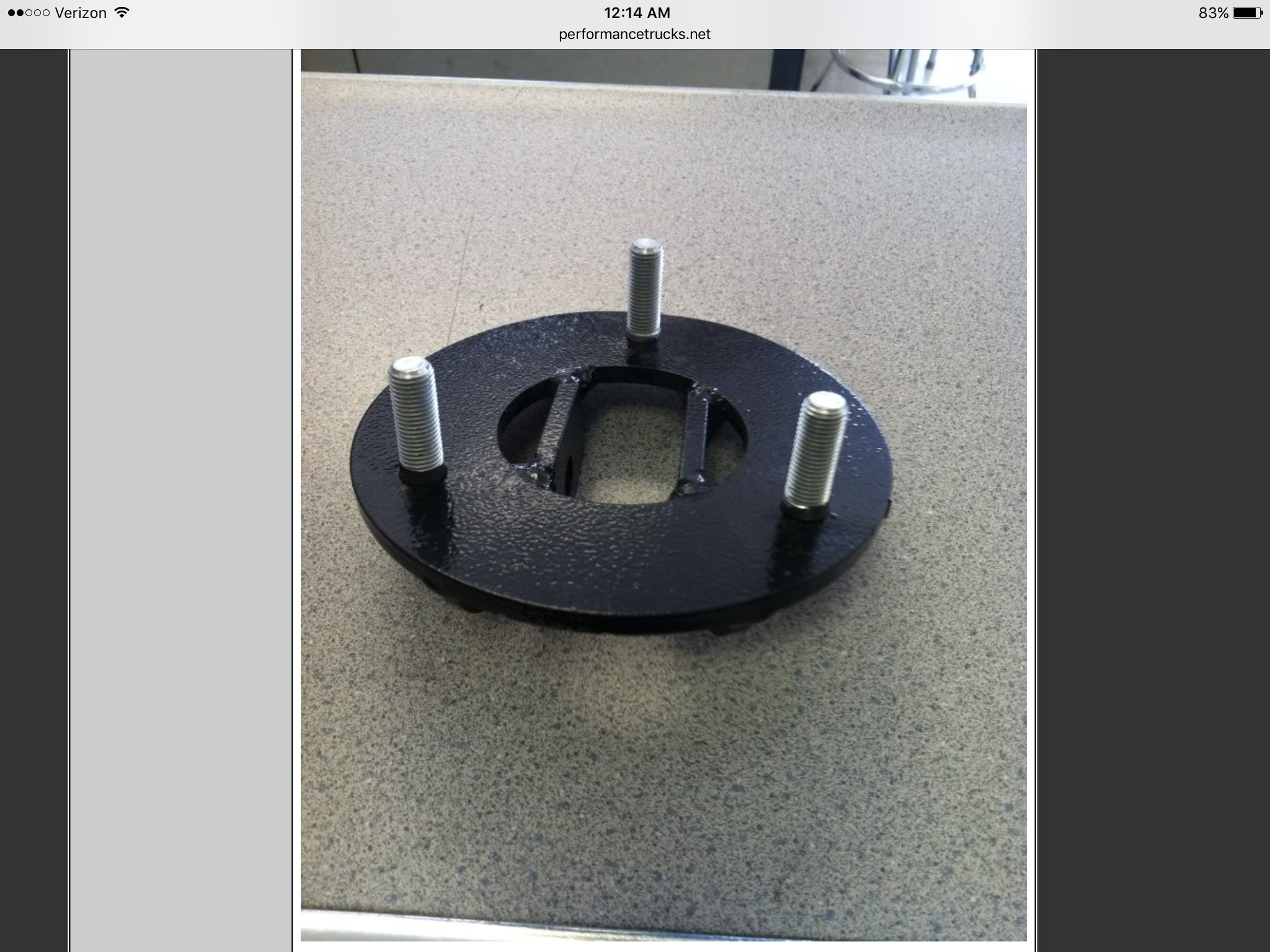

Yea thats why I boiled my gmt800 stuff done to just "measure like the picture". Everyones "3in drop" or whatever is not always the same, so I insist everyone measure. Spring rate is relatively easy. Everything just depends on the ride height. It will be nice on the GMT900s to be able to use a 3in shock and have a selection of heavier springs.
Yea I will be making a thread, just waiting on Eric's feedback first.
Here is the back of my brackets btw,

Nice, I'm lookin forward to this.
They look great, I like how you pieced them together with the key slot. Perfect fit every time.

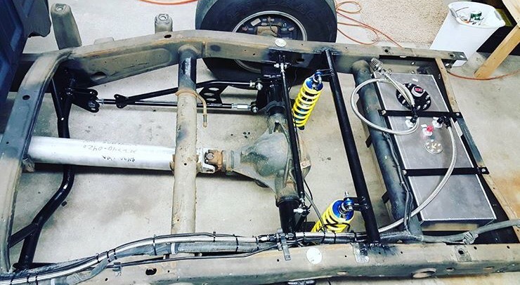

I have the back figured out
