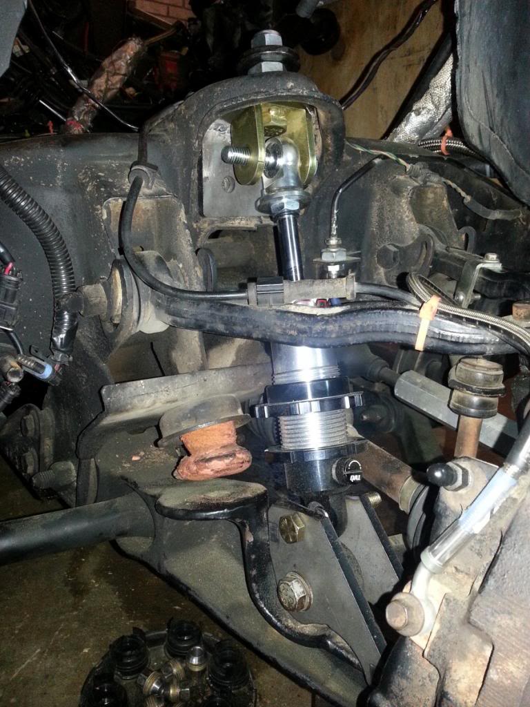

Energy suspension ones...
And coilovers. ride-o is mucho better-o

That is completely diffrent than how mine look. Mine are on the subframe stock not on the lca

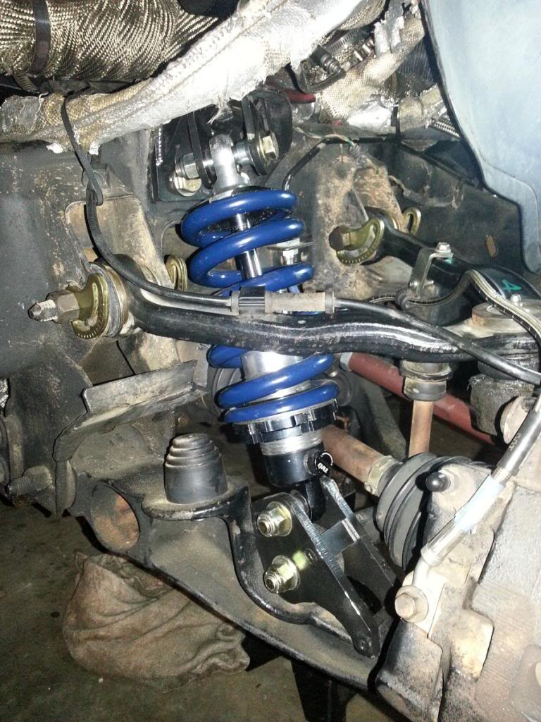

I know, I was saying that is what I did for front bumpstops at the same time I did coilovers.
My factory ones...

oh damn yours look worse than min do haha. ill have to take a look at my LCA and see if i can do something like that
do you by chance know what PN of bump stop you used?
Thanks for the pics

I think they are these, http://www.summitracing.com/parts/ens-9-9101g/overview/
Just drilled a hole in the LCA through the bottom. Piece of cake.
