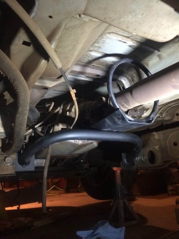

Originally Posted by hsiriyob
will you build it into the crossmember you make for the 80e? Im interested in purchasing one when you get them done!
Mine bolt it on the tranny mount. This is the bigger ring, I have a smaller ring for stock driveshafts.

Benefit of 2 piece?
Old May 22, 2014 | 10:43 PM
  #23
texasglock23's Avatar
Joined: Jun 2007
Posts: 1,569
From: North DFW, Tx
stronger...
Old May 23, 2014 | 01:32 PM
  #24
thewrx's Avatar
Joined: Jan 2009
Posts: 553
Likes: 6
Seems like you could make a onepiece just as strong without introducing additional weight and moving parts that could fail?
Old May 23, 2014 | 11:34 PM
  #25
LS1TRUCKGUY's Avatar
Joined: Nov 2005
Posts: 2,452
From: Deer Park Texas
They do make 1 piece units, but have you seen how long a 1 piece driveshaft is on a crew cab truck?? I feel better with a 2 piece.
Old May 24, 2014 | 08:56 AM
  #26
dirt track racer 81's Avatar
iTrader: (45)
Joined: Jun 2005
Posts: 9,439
Likes: 13
From: Hennessey, Oklahoma
1 piece is just too long. My stock 2 piece was handling 800 hp behind my 370 nitrous motor.
