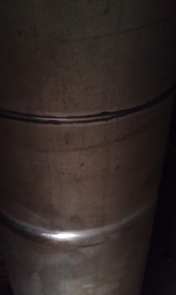

At 8" drop in the rear do you think it might had been rubbing a crossmember or something? I know mines did and I replaced it with a 2 piece on time. Name:  IMAG1235.jpg
