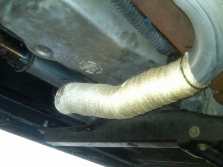

thanks for the replies. before I read any of them I went and bought a 50'x2" roll of header wrap. $50 at Oreilly auto parts.
And it seems to have WORKED!
after installation, I let the truck warm up for 20 minutes, then took it on a BRUTAL 40-min test drive in stop and go traffic. The shifting was flawless and smooth.
I used about 35' of the wrap and SS ties at the ends:
I may need to seal the wrap with a silicone spray, we'll see. I'll post an update in a few days, hopefully the problem is fixed.
