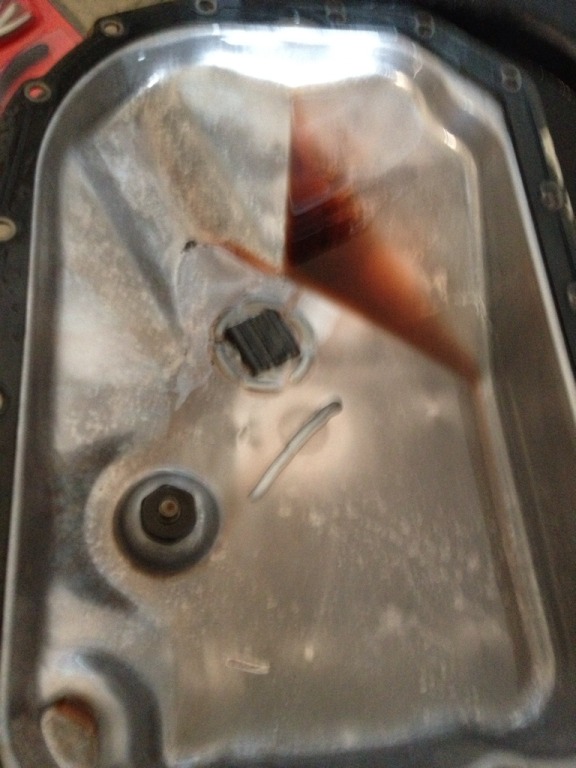

And my pan. I was actually impressed their wasn't too much clutch material in it. No metal shavings either! Defiantly a weight off my shoulders! The strips in it was my finger lol
