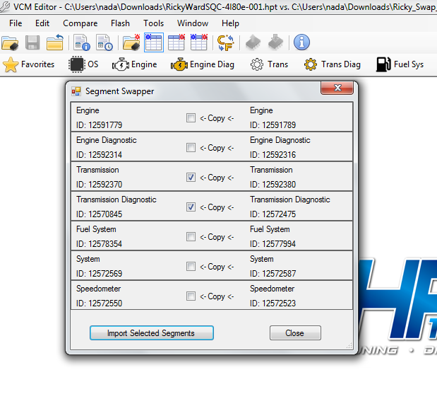

Use my attached file to swap FROM. Open Menu Compare, select my file. Then do a segment swap. This file has the same OS as yours as is needed.
Select both the trans and trans diag options. Ensure trans type is still 4l80e.
Let us know how things go!

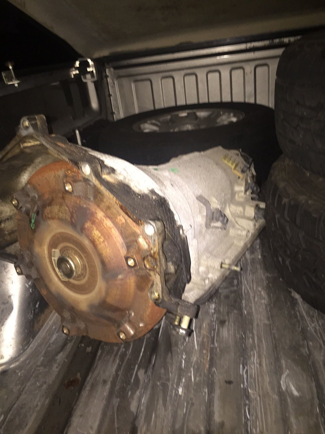

For clarification... The ISS (input shaft speed) sensor, goes to the front of the transmission, the sensor closest to the torque converter, on 4wd 4l80 the OSS(output shaft speed) sensor is in the transfer case, and typically have a plug in the oss hole of the transmission case. On a 2wd the oss is closest to the tailshaft housing of the transmission,
i have a 4wd on my front porch i will get a better picture of tonight when i get home....
This is a 4wd with the rear plug
You can see both in this pic....on the 2wd
