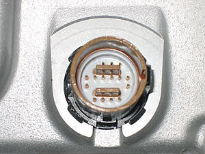

Sounds like a common wiring issue for all solenoids to be bad.
I've read that a leak of trans fluid into the trans connector can cause all sorts of issues.

I'll look into the connector. About to pull the pan and check the filter. Does anyone know how to check if its the TCM? Id hate to buy a new trans and have it be a tcm and I'd still be SOL

It could be really simple if you didn't get the connector seated all the way when reinstalling the trans. Disconnect it and hook it back up push down until you hear and feel a solid click.
