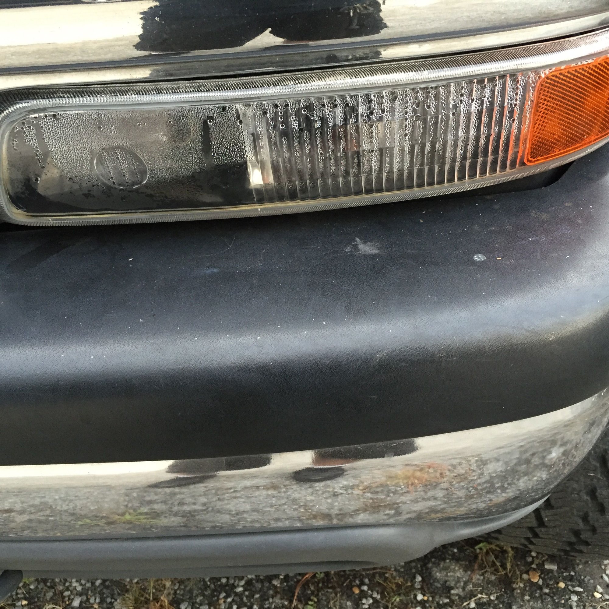

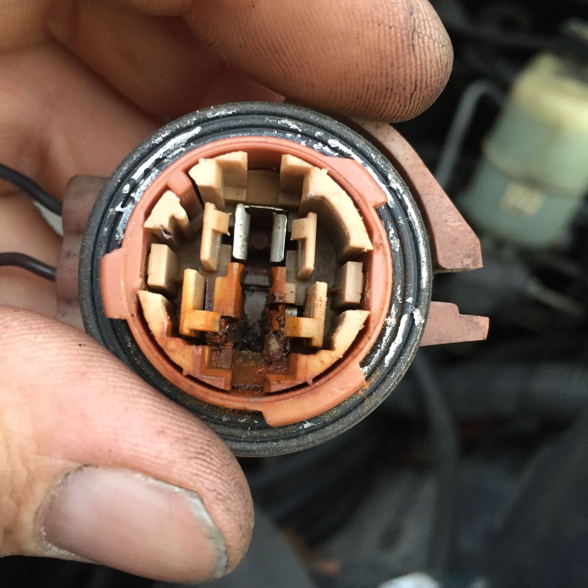

After the rain weve had this weekend fron the tropical storm that blew through here, everytime i turned the headlights on or tried to signal a left turn the turn indicator would come on steady and just stay on.... Actually been happening internittently for a while, but finally decided to do something about it, and ended up needing a turn signal socket and these aftermarket replacement lenses are JUNK!!!
Contacts in connector corroded... Badly
New socket in and installed
Left signal lens had about half a cup of water in it...
Right lens is dry
Debating on getting a set of euro type led lenses or going back with factory lenses... At some point i want a set of hid headlights and fogs with a set of halo projector lenses...
