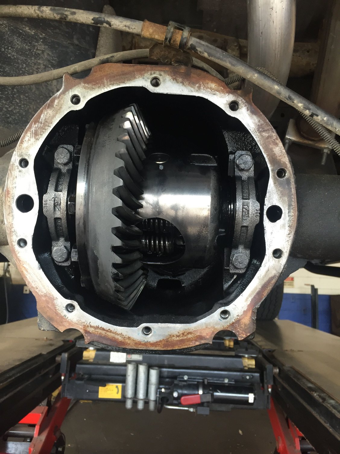

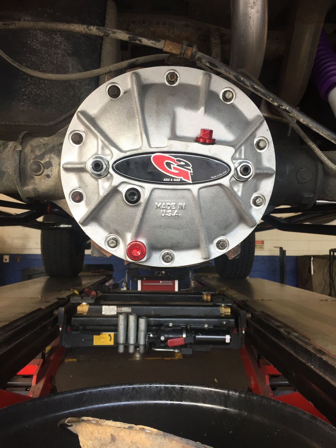

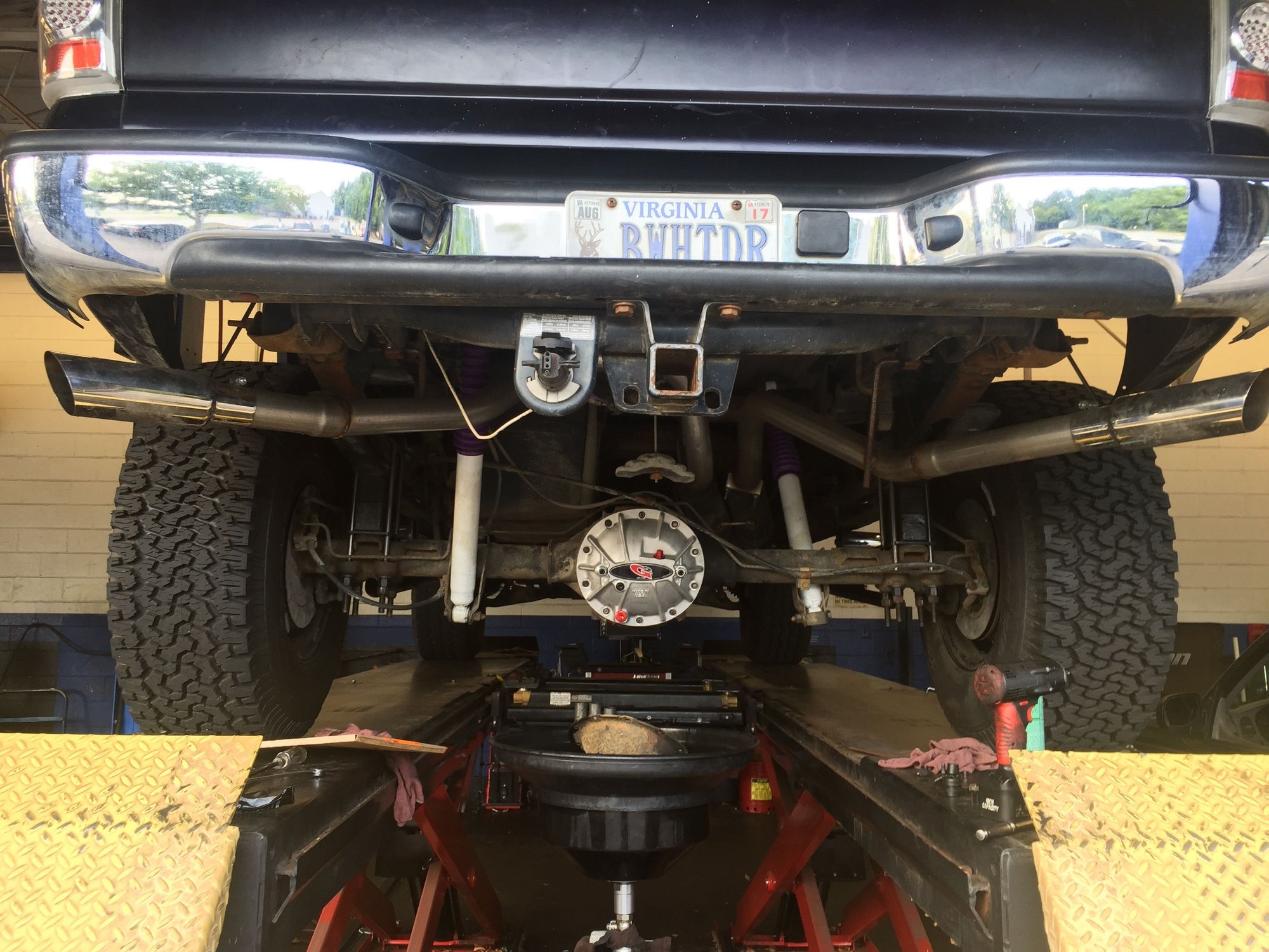

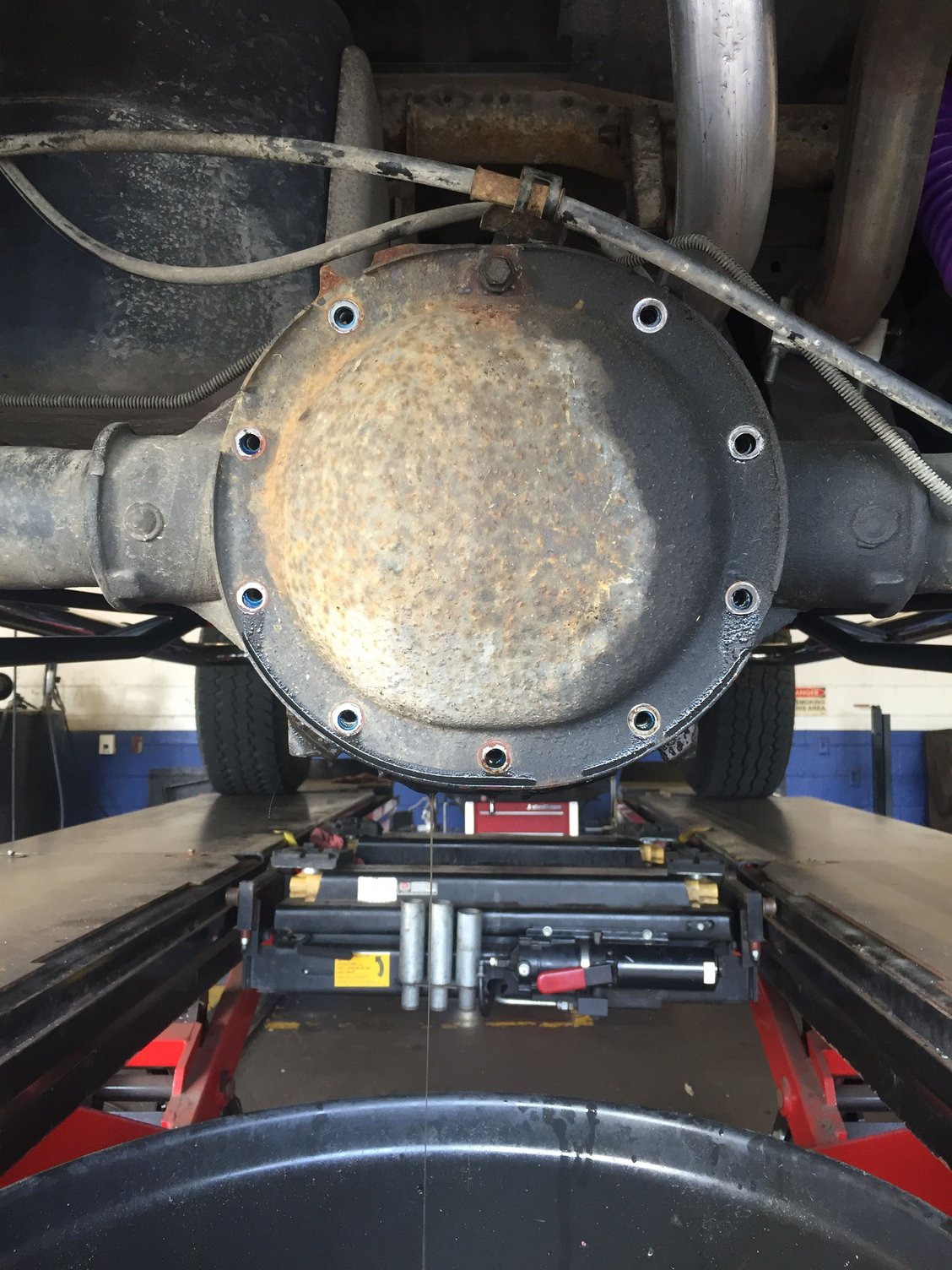

Ran out of work today so had a chance to install a tire i came across for nothing last week, as well as install my diff cover... Only complaint is they sent no instructions, and standard thread pitch bolts...... Luckily i had some old oil pan/timing cover bolts laying around.... I have some 13mm headed 30mm bolts i am going to swap these out with tomorrow or tuesday... And properly torque as i forgot my torque wrench and the bolts i want to use when i left my full time job friday evening....
Old cover coming off....
Really happy to see the lack of metal and awesome gear pattern.... I will be leaving the rear end alone.... Been over ten years since i rebuild the rear end.... Sadly this is the first fluid change and the fluid was a little dark but cant complain....
New cover on and torqued, i plan on replacing the bolts and possibly trying to center the cover better, really not excited about how the cover lined up, but its not leaking so i may just leave it ither than swapping out to me bolt at a time...
So much better looking that the old steel cover!!! Still debating on painting it purple though,,, have this really cool looking metal cast paint i am going to try on an old ac bracket i have first and see how it comes out!!!

And on a side note i had a chance to ply with the truck a bit more today, what a difference a set of traction bars new shocks and a couple tires make..... Now to get the left fromt tire from cutting into the fender when i turn.... Finally pulled the inner fender off the fender well thai morning going to work probably mod the fenders one day this week...
