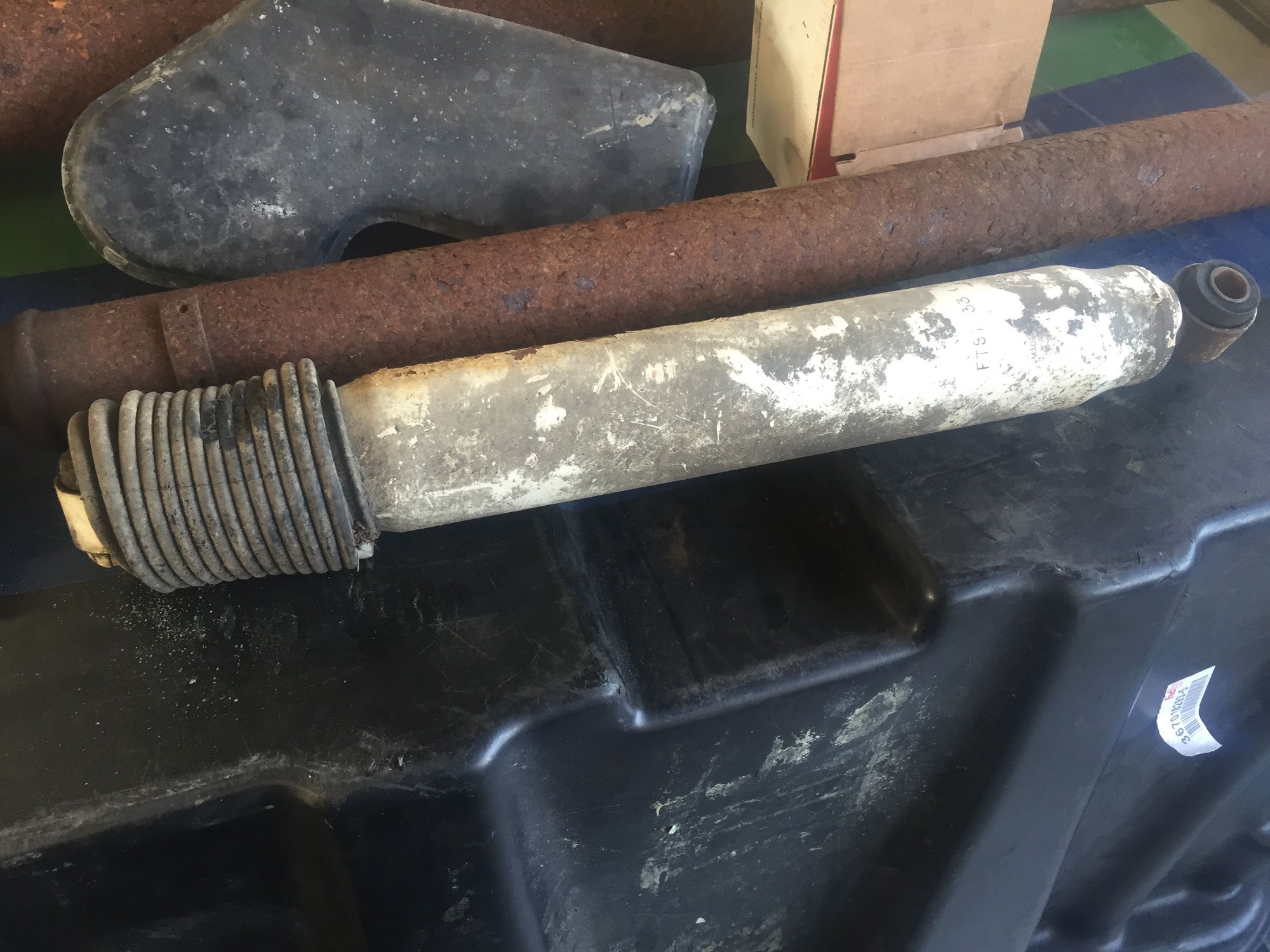

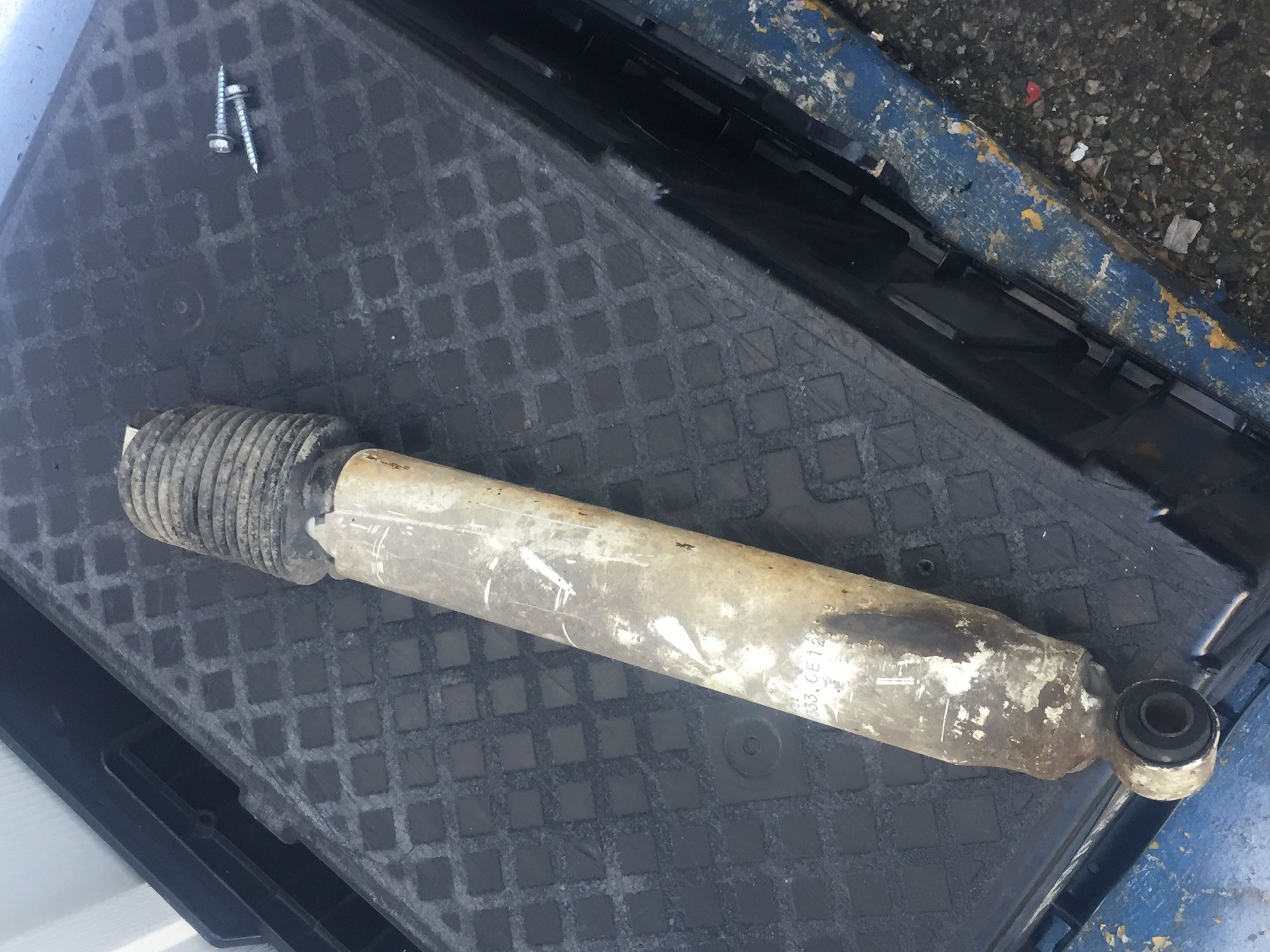

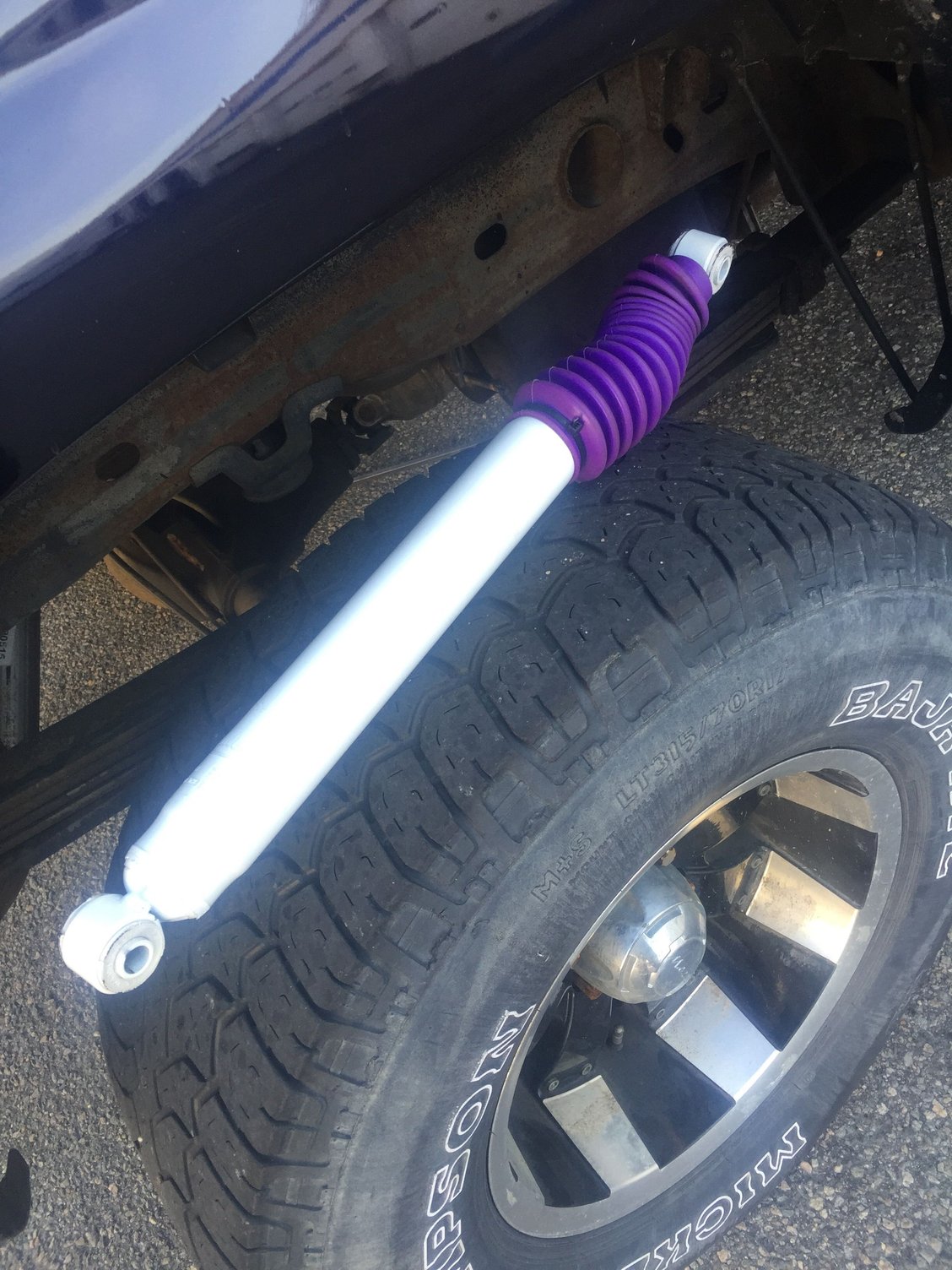

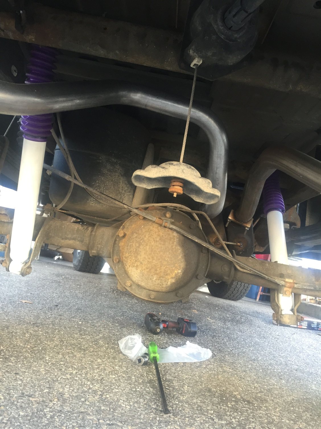

Broke down and bought new rear shocks.... After measuring the at rest height and the fully extended length with the shocks unbolted i realized how bad they were...and turns out i had almost two inches difference in the extended length of the shocks i had vs the axle at full droop..... Full droop my shock mounts center to center were 29.76.... Fully compressed suspensionwith jack under the axle on one side was iirc about 20 inches and with the truck at rest were 26.50" i found a set of shocks that were instock locally, ranchosbut better than nothing and got them on.... If i punch it now she gets a little squirrelly but dont seem to have as much axle wrap.....
Old left shock... No rebound at all...unbolted it and it actually retracedabout an inch....not good!!!!
Old right shock.....no rebound either.... Didnt retract thiugh....
New shock with purple boot....
And both in......
This pic really makes me want to clean up the frame and rear diff, along with everything else back there as well as a diff cover/girdle!!!
