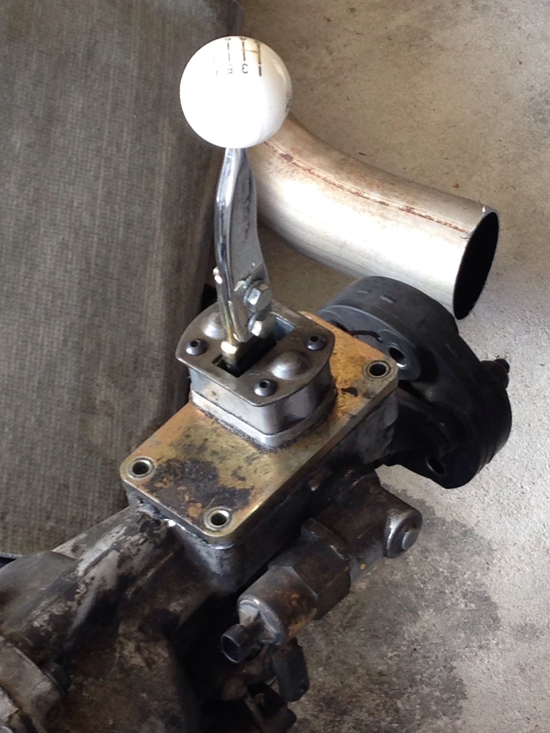

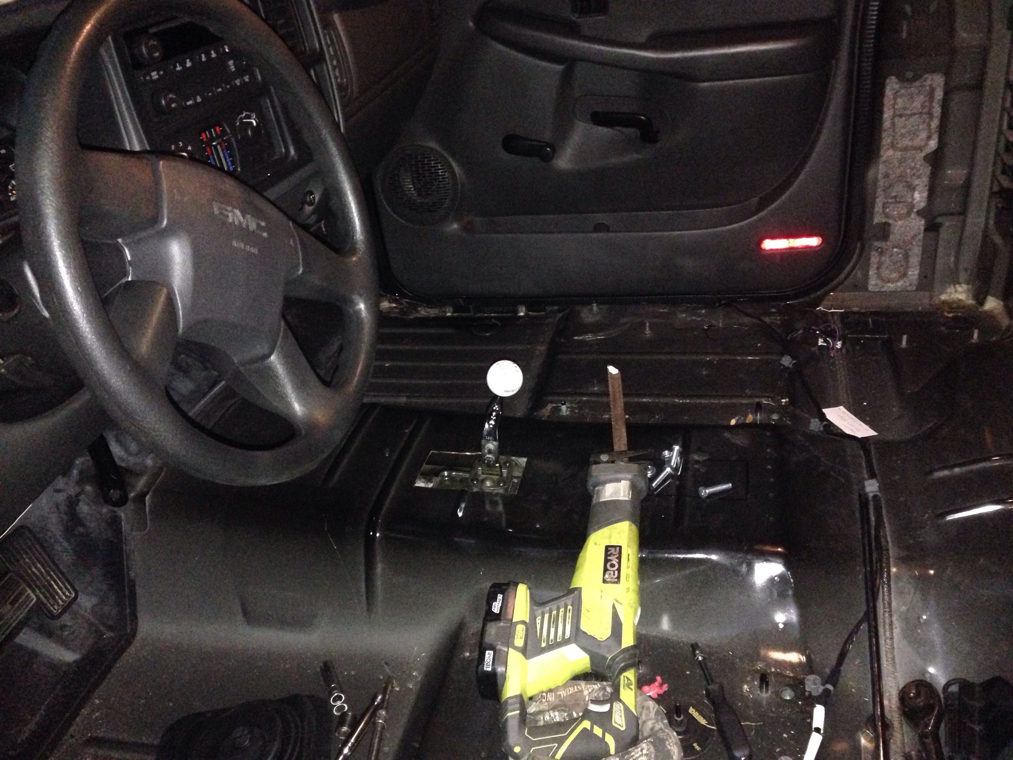

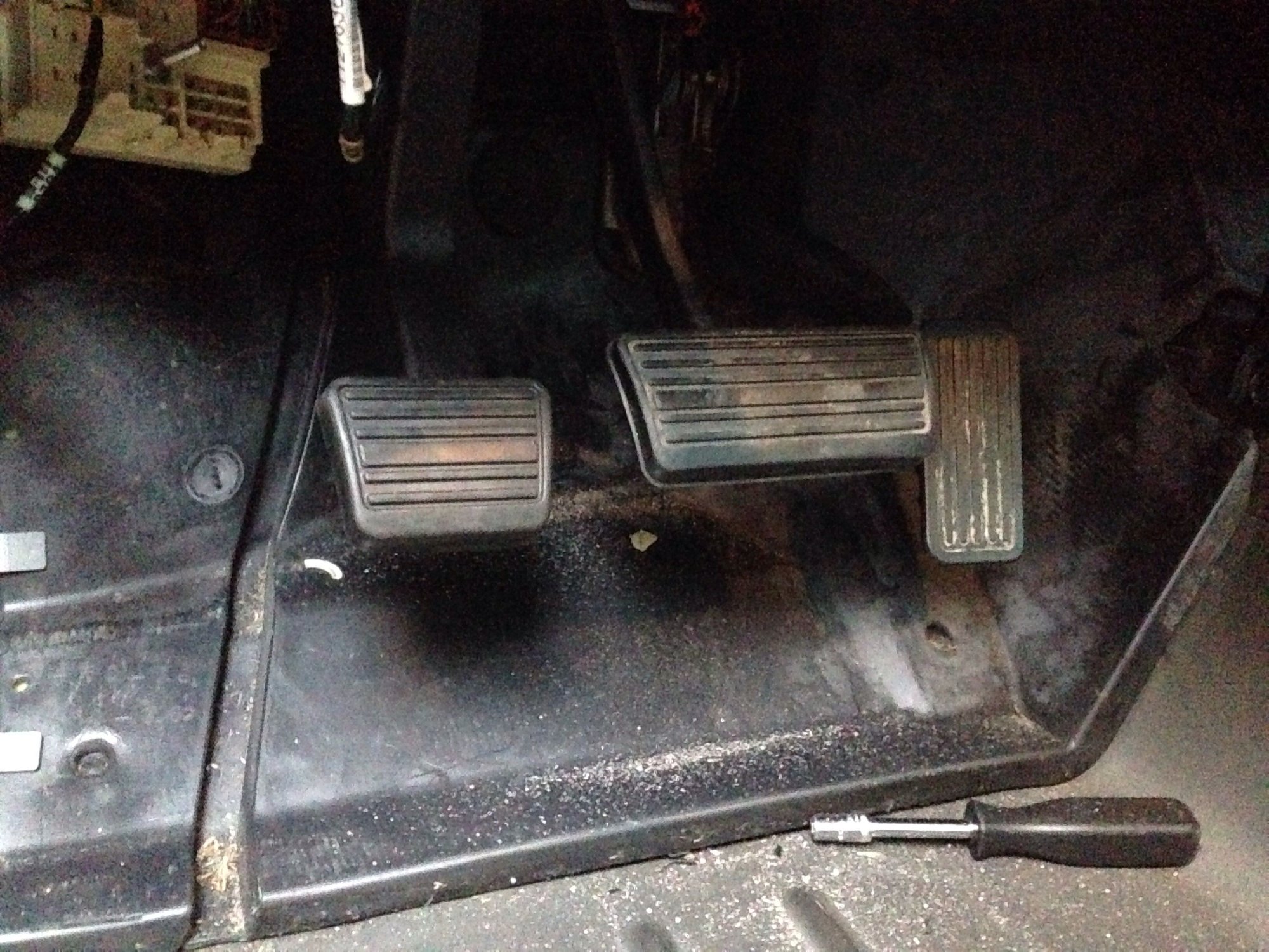

Camaro shifter
Cut the brake pedal down, just centered the pad for now
Used a hydraulic hose from a jeep tj
Need to do just a teeny bit more cutting on the floor

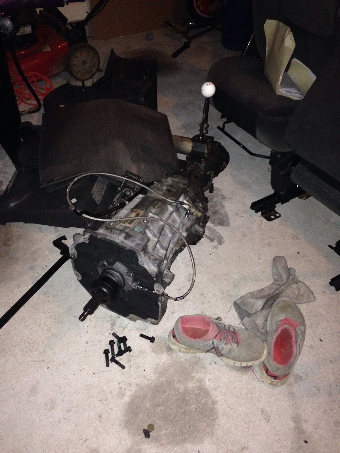

Put the trans in today, what a bitch that was by my self. I can't wait to drive this thing!! Just need to bleed the clutch, install the drive shaft, and put the interior back in. I do have a slight issue. The yoke from my truck does not want to go on. Goes on about half an inch the stops. Anybody ever had an issue like this?

I had the same issue and was trying for an hour, then realized the yoke has a double wide spline. I lined that up to the one on the shaft and it slid right on.
