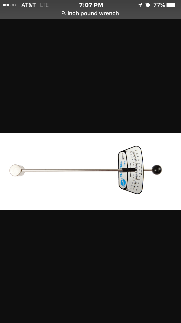

It says inch/pounds on it! Its this one

Are you getting an initial torque reading on the wrench to get the yoke spinning, then it goes to zero? If so, I had the same issue. I had not crushed the crush washer yet. It was getting the initial drag from the yoke seal, but then once it started to spin, it went to zero drag. If that's what's happening to you, then it's safe to say you haven't begun to crush it yet. They say it takes 3-400ft-lbs to start the crush, but then it goes up very very fast after that

Yeah im getting 20 inch pounds when i pull the handle... im thinking i havent crushed the sleeve yet but what has me confused is why the wrench is saying im there already! Unless i have to tighten it and then spin the yoke a little and check it again or something?..

I google the Yukon install video that's on YouTube. But after watching a ton of videos I noticed that the proper way to use that wrench for this job is to pull it very evenly (I used one finger) and keep it steady so you can read drag with a slow spin on the yoke. If you just yank on the handle it will fly up in value, but I recommend watching this video to see what I mean
