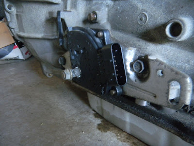

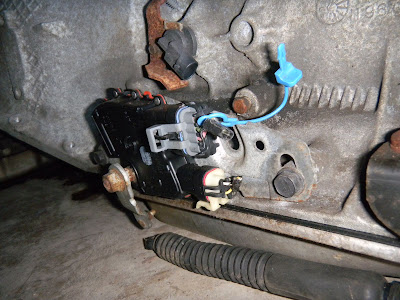

But I just came across another issue... atleast i hope its not. The Module on the side of the 80e seem to have an extra plug outlet than my old 60e
60e
80e
What do i do?
