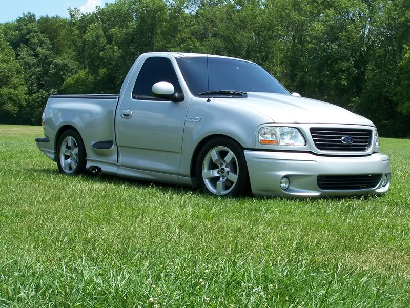

I am trying to keep from going that low again, lol.
