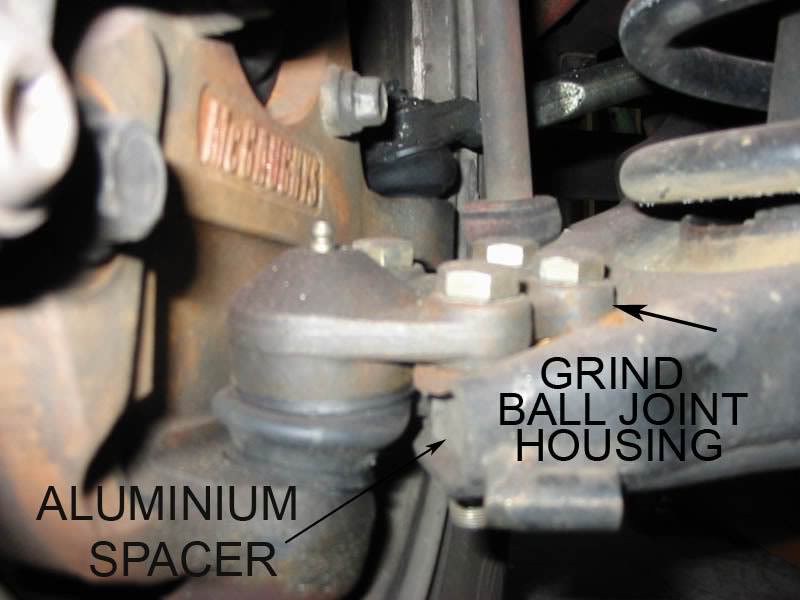

I'm running the NAPA ($52) balljoints on my 4/6 drop. Installed in 2005 with no issues in 15 years.
McGaughys 2" inch (16"+ wheel) drop spindles.
