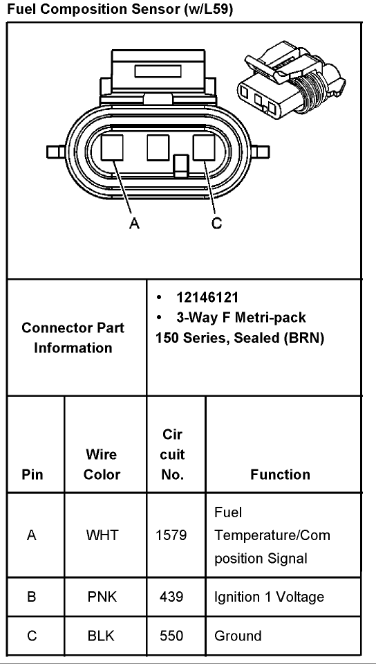

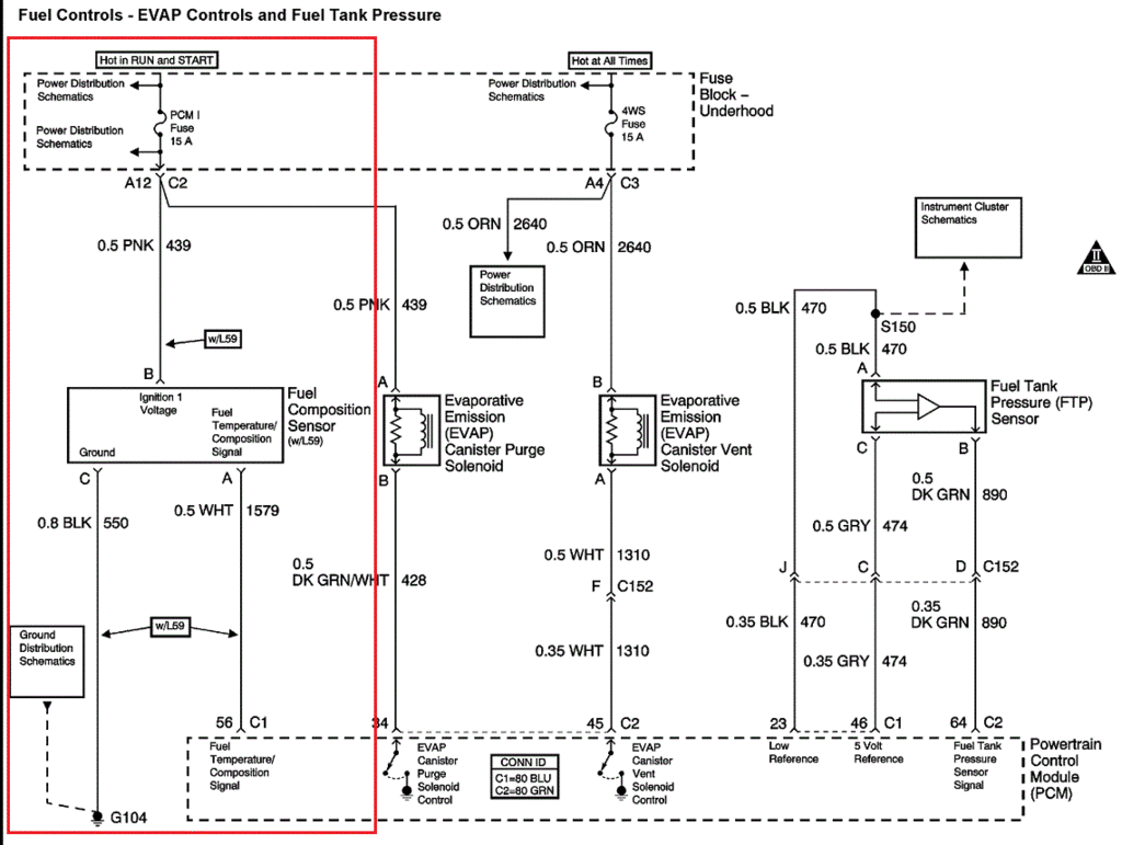

Thanks boys. Looks like I have a flex fuel pcm. Maybe I should add the sensor and see what happens.
