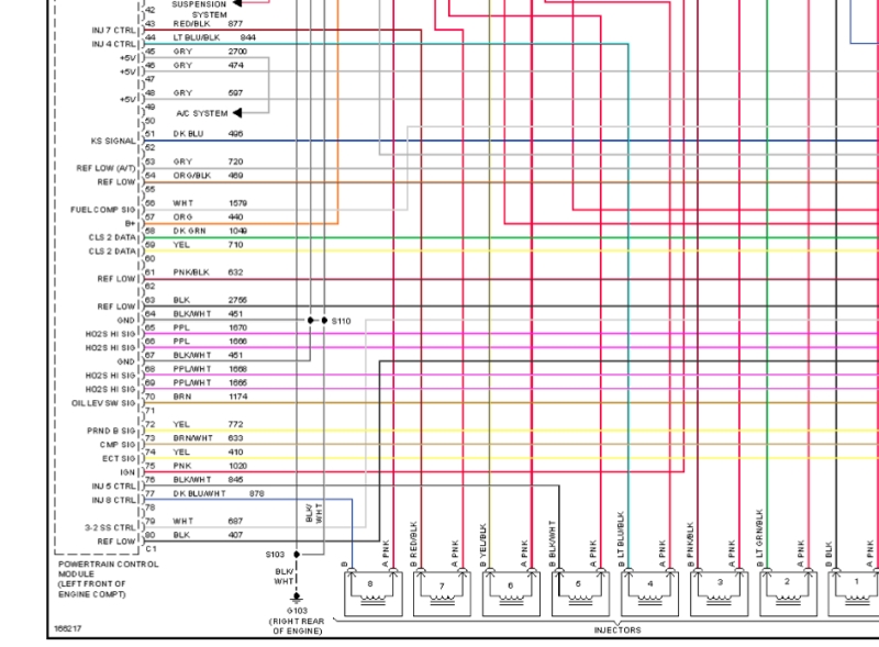

I'm bringing this thread back up. I saw Dsteck's tutorial on adding the ethanol sensor to the GenIV cars and it got me thinking again. He used the following parts and the price on the sensor is only $50.
Ethanol content sensor (GM part number 13577429 is the cheapest)
Sensor pigtail (GM part number 13352241)
Swagelok part number SS-600-6-AN (best option) or Russell 644123/640863 TWO OF EACH
I checked the wiring in for my pcm and it looks like pin 56 is the input for the flex fuel sensor. If I wire the sensor up, add it to my return line so it isn't a restriction, and put the correct values in the stoich table, will everything work as it should?
