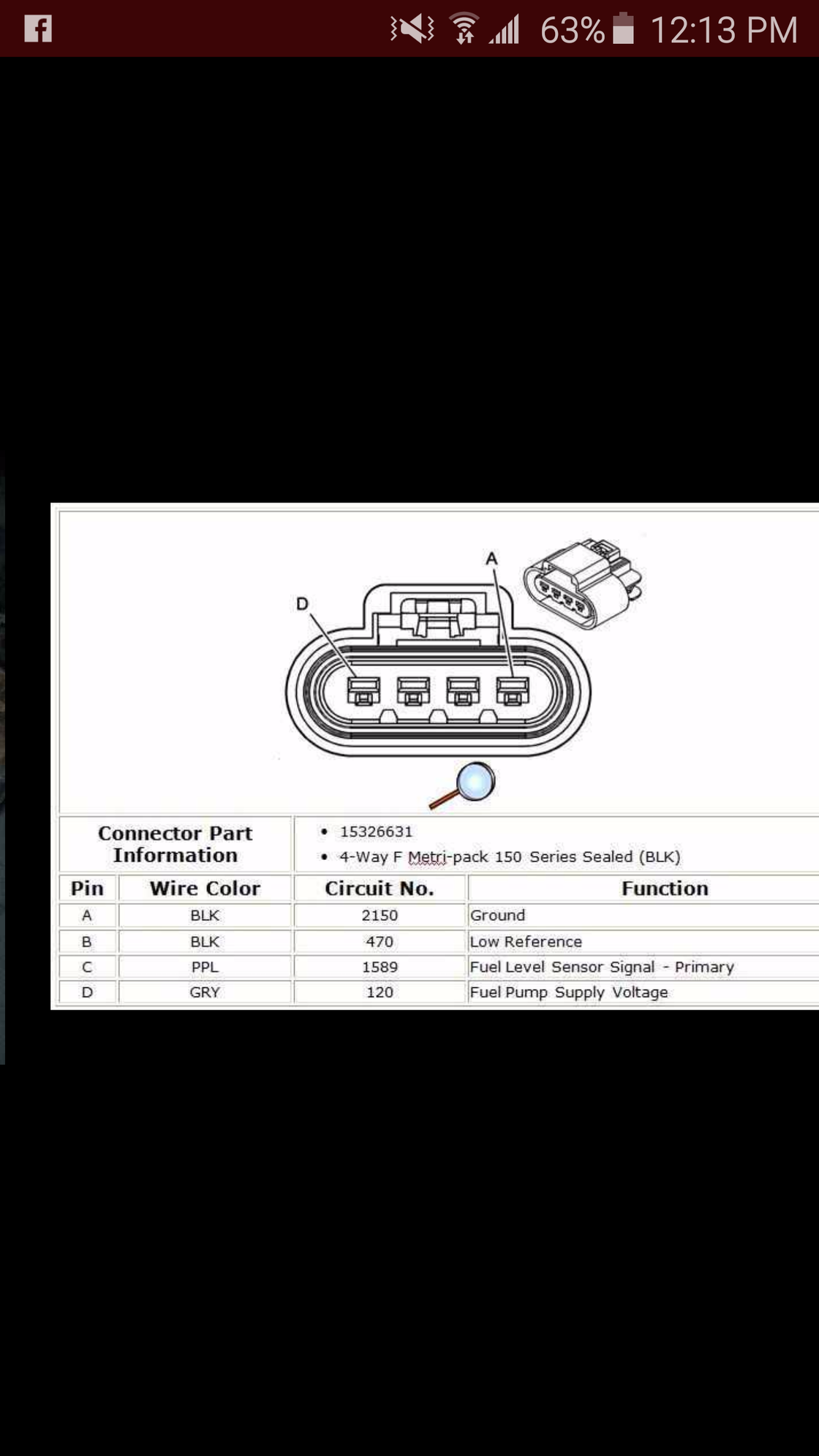

The harness on the right is factory harness from pump to the lid, do any of you know which is positive and which is negative. It says A,B on the end of the connector and a diagram i have i think is incorrect l, because it show A as ground, but B as low reference. Should just be 12v and ground right?

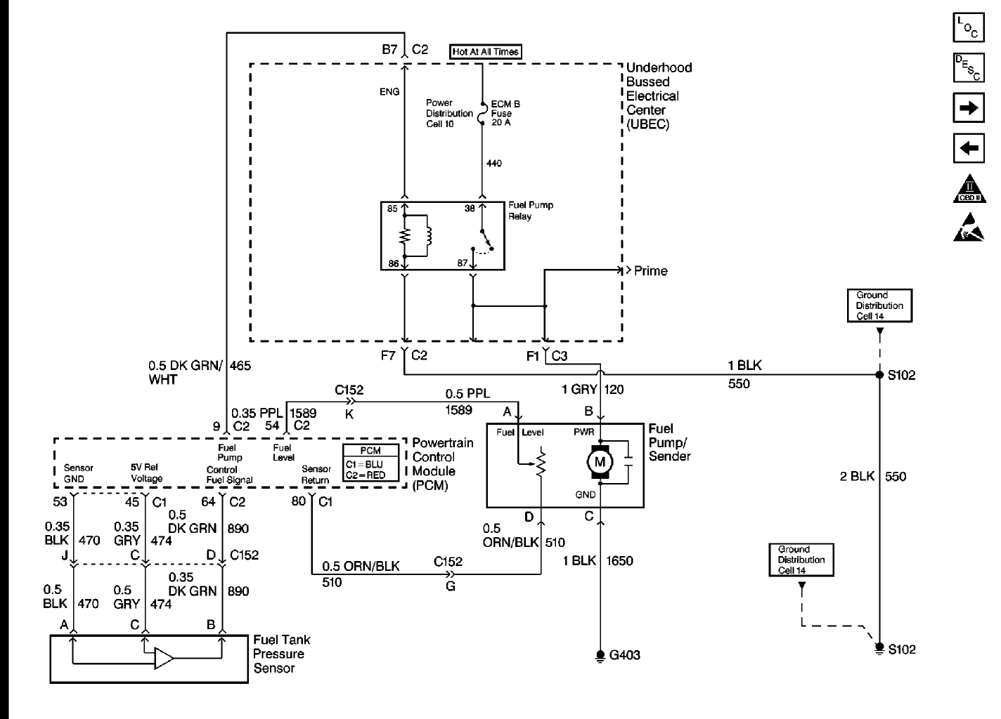

This diagram

This looks right
Black-ground
Gray- 12v
