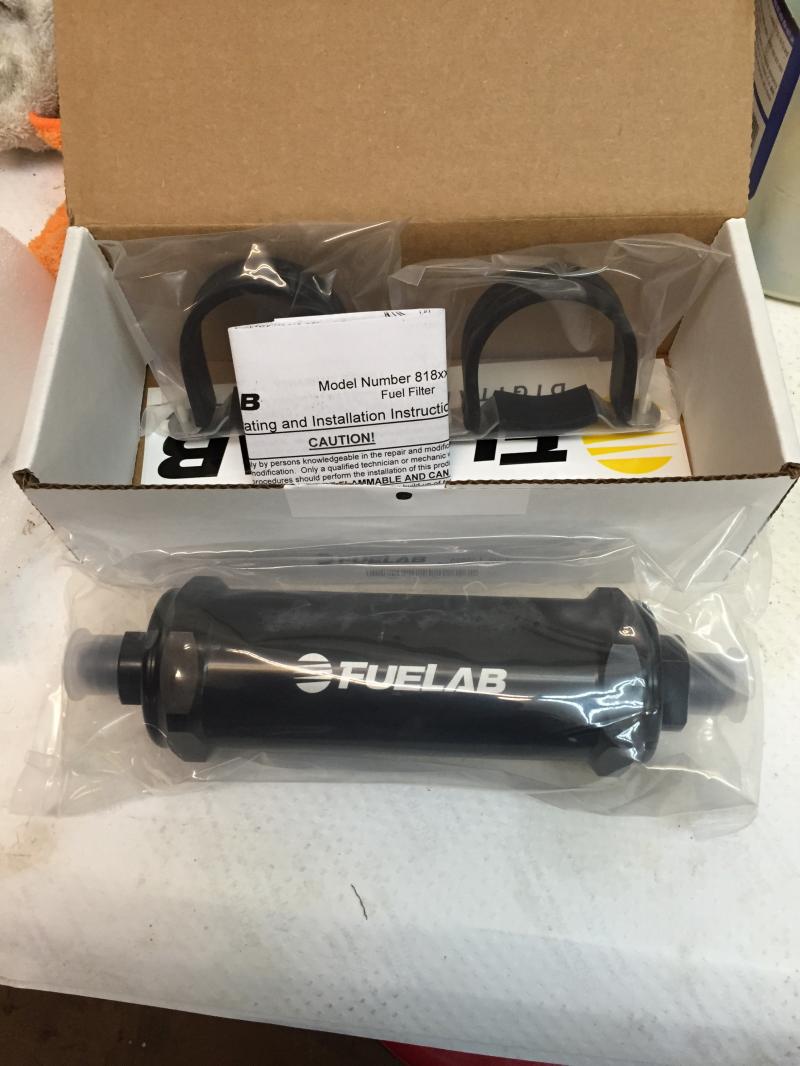

Ya Mike, how did this work out?
I have this one

I like those fuelab filters, but they're ridiculously expensive. I've been looking at the 6 micron fiberglass filter for ethanol use.
Some people on tech are advocating the use of big diesel spin on fuel filters that supposedly work with E85.
