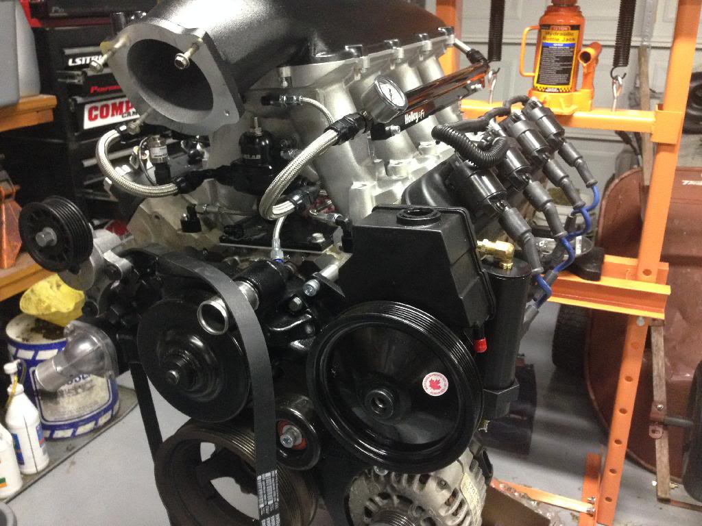

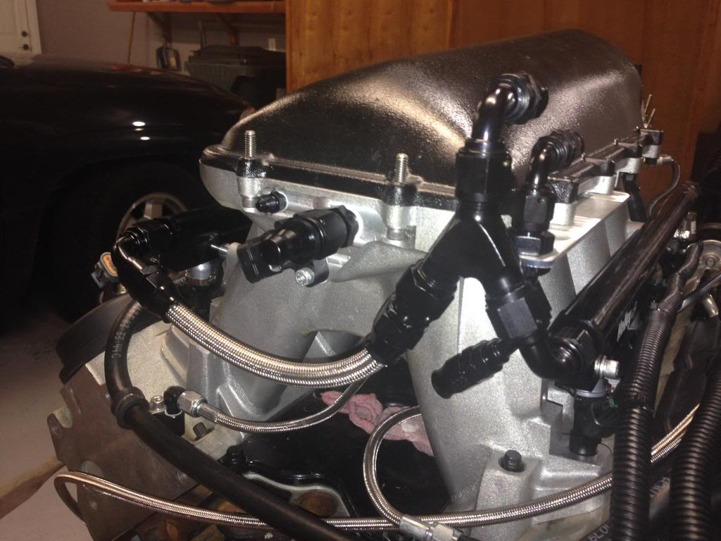

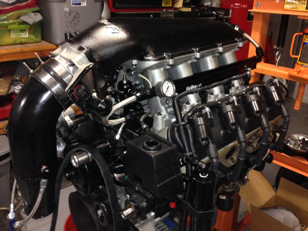

I tired the "preferred" way, i did not like it... it cost a small fortune in fittings... Way to complicated... It did work fine thou... I ended up swapping to the setup you have pictured second... It was kinda fun to make but simpler is always better. I have also tried the dead head way too, no issues with that either...

Corey big thanks! Always nice to hear what's proven. I have literally stalled my project by weeks by cutting, refitting, maneuvering y fittings so I can somehow plumb them into each side, etc etc. I have several hundred dollars in fittings that I still need to return. I will run it the simple way pictured second. F**k the truck would be running had I not over thought this.

i have had great luck with the last layout, dead heading. I dont have a choice though because im running a oem returnless fuel rail.
