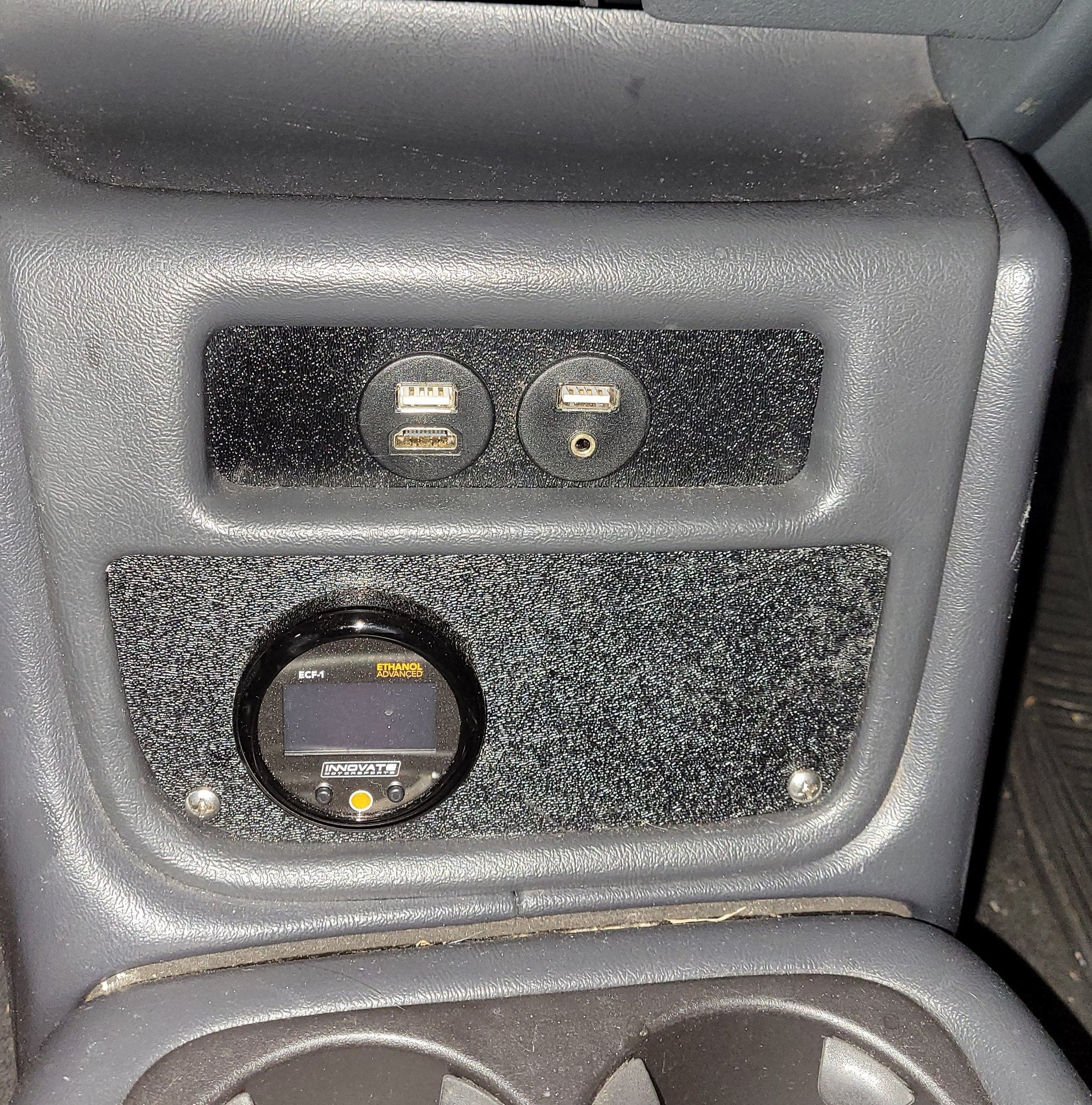

Could I see a picture of your in cab set up? Super interested in this. I like the idea of the walbro being constantly submerged.

Crappy cell phone pics. I replaced the cassette and CD case holder with block off plates for gauges and Android Auto hook up's.
