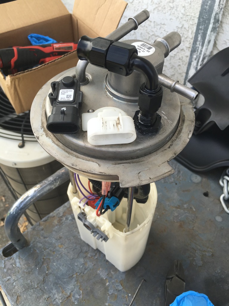

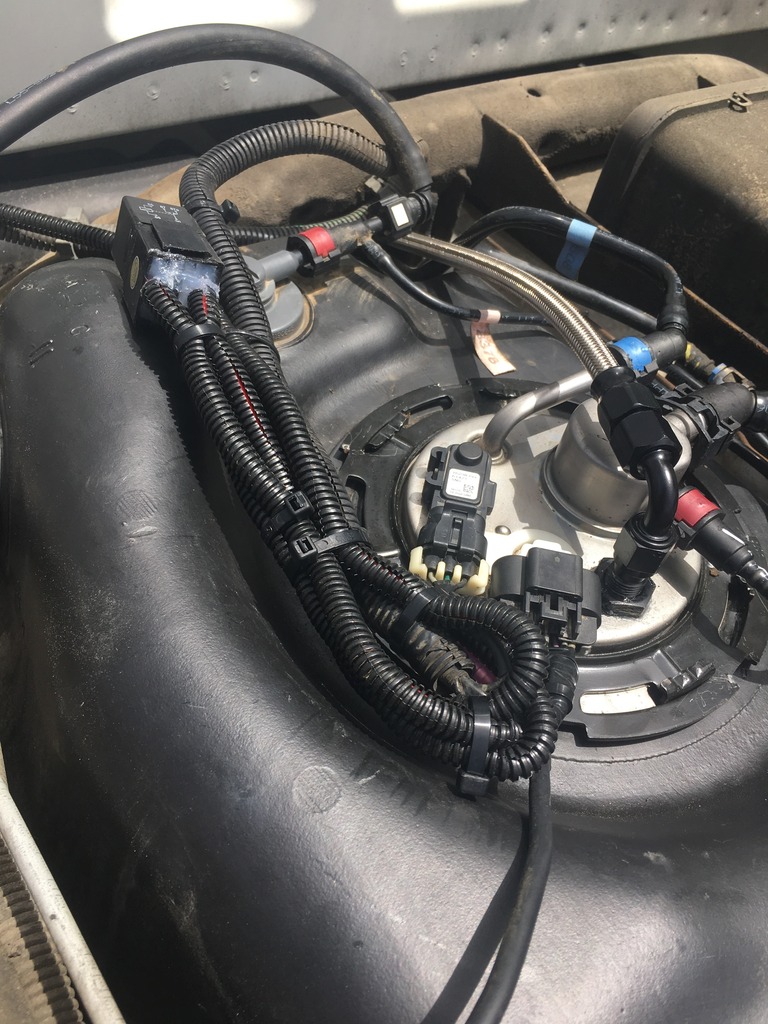

Got my bucket all wrapped up. Took some pics. I'm just leaving the stock feed tube and elbow so it dumps directly into the bucket.

Looks good, what are you using for feed -6 or -8
-6 feed. I'm almost feeling like I should have just done a 450 instead of the aero 340 in there now. But should still support my 600ish hp I'm making now.
Also messed up and ordered a 40 micron filter from summit, only realizing that that's not that much filter. I have a fuel lab 10 micron filter come tomorrow and getting everything wrapped up.
