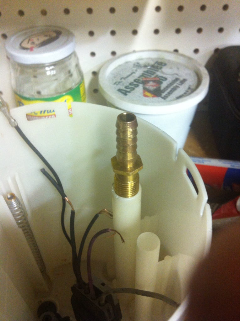

Next time you have it apart you should try to take advantage of the stock venturi.
Check out the pic here:
Thats where the factory return dumped into after being fed into the regulator that was in the bucket. The brass fitting is to make it so you can attach your return hose.

Ohh, I was under the impression that the Venturi system will not work once the factory regulator is removed. So I just had the return dumping into the bucket to keep it filled. I do remember that when I sat the module back in the tank, even at an 1/8 full, fuel was already filling the bucket back up.

While youre in there change around your return line and I bet the problem goes away.
Old Jun 27, 2016 | 11:25 PM
MikeD.'s Avatar
Joined: Mar 2012
Posts: 275
So just plumb it straight in to where the factory regulator was?
I honestly don't even know how the factory Venturi system works, I know it draws fuel into the bucket, but I don't know how the return from my new system will keep that working. But I will try that!
