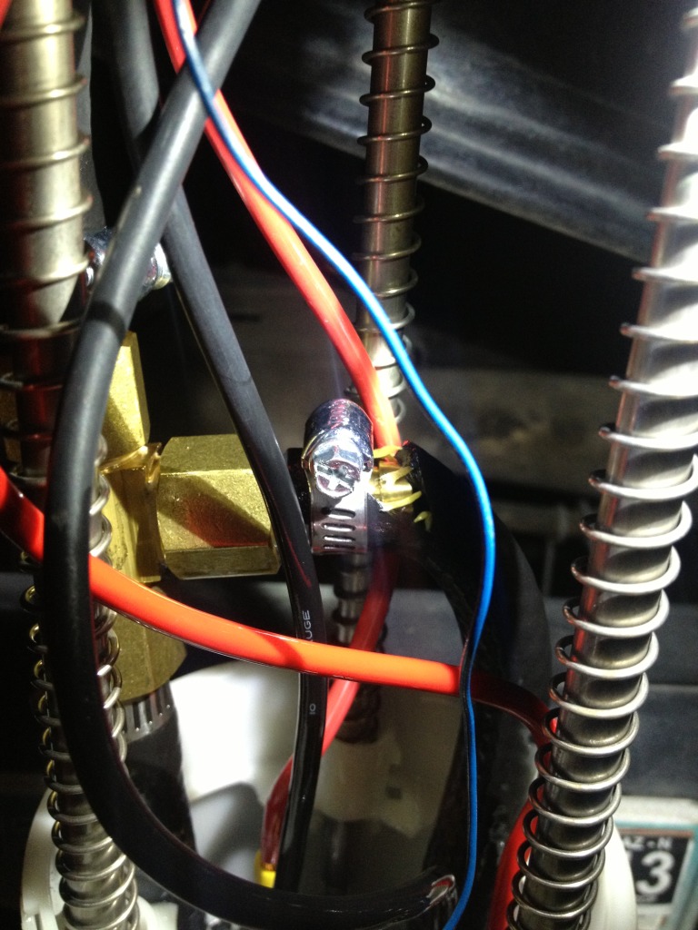

Something's up with my truck. Just got back from a 4 day trip in the field, truck started fine. About a mile down the road I notice that my fuel pressure is around 40. Should be 50 at cruise. Get home and its idling at 20. Turn it off. Turn the key to the on position to prime the system and the needle doesn't move. Hook up the second pump and I only get 10 psi to prime. Any ideas?

Split a hose

That is a pretty sharp turn for that hose. I would change that fitting to a 45
That's what I said in the build thread .put a "y" fitting in there .

or atleast a 90* fitting..
I put a -6an Y in my tank and nothing is in a bind.

I got it fixed with the hose walbro sends in the install kit its alittle longer than the hose I had on it. Im going to look for a better y fitting and some more of the gates hose.
