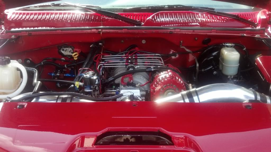

heres mine and i dont have any issues :
Good to hear. How long you been running it like that? Where you running the regulator?

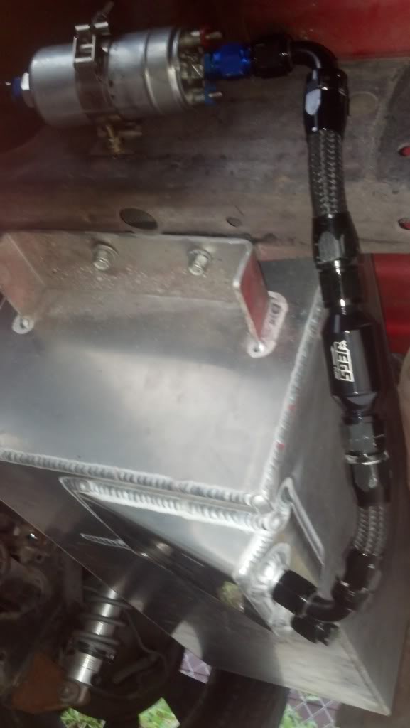

on passenger side firewall, i tried to put it on the rails bout with my intake it was virtually impossible, been running it for a few months now! it primes quick, the pump shown is the jays racing upgrade of the bosch 340 though.

so your using the bosch pump still??? Did you ever run the walboro like this? by the way, beutiful pic

i personally dont see a issue regardless, as long as youre as close to the tank as possible, you wanna keep the feed line to tank from pump as short as possible. before i had a internal walbro ran on stock fuel lines, never used a walbro external. i think if youre with in a couple feet from pump to feed line on fuel cell you'll be fine, but thats just me.

Why didn't you put the FPR back near the tank?
Old May 12, 2012 | 10:08 AM
skeet's Avatar
iTrader: (18)
Joined: Feb 2007
Posts: 3,157
From: P.A. TX
there you go, solve your own question
absolute pressure at the rails, if the FPR is at the rails and youre reading proper pressure then you know you have enough fuel, if youre back towards the tank you could end up with fuel pressure problems of dropping PSI before it hits the rail.wanna keep the lease amount of fuel pressure drop going into the rails
