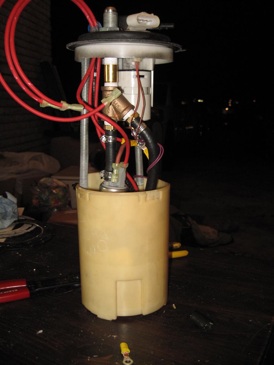

The good thing about the holley is that you only have to bother with 1 fuel line. No Y's or T's in the tank. If 2 450s will fit in the bucket, the Holley should as well.
Old Oct 1, 2013 | 07:39 AM
Atomic's Avatar
I have a gauge for that
Posts: 16,282
Likes: 438
Huge hassel, right?
I dont have mine out, but I dont think the hole in the top will fit a 5" pump setup.
