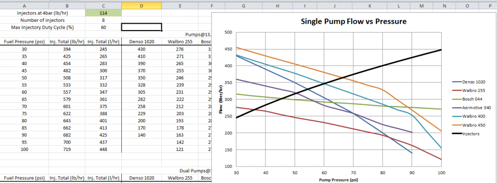

Looking at atomic's spreadsheet for fuel pressure, even at 60%idc I won't have enough fuel pressure with a single Bosch 044

I would have to set base pressure to 35 which would be too low

What injectors do you have?

FIC 1000cc 114lb at 58 psi

Run the pump, see where your at.

Yea, my fittings showed up today. All I need is the fuel line. O'reillys show that they sell it, And napa should have it. its the gates 27097 submersible pump. I can still run the inline bump if needed. to help out. Im saving up for a duel walbro 450 intank set up
