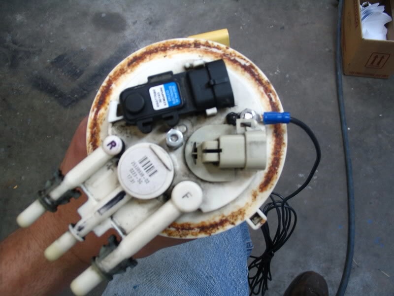

Like mangled did in his write up

To keep space down, can I wire the neg on the pumps together and run one wire up to the top? Will use at least a 10ga wire. Then I will have two more bolts, one for each pos wire. Will this work or would it be better another way?
