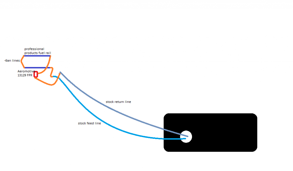

Old Feb 24, 2013 | 04:01 AM
  #129
AndysC3's Avatar
iTrader: (14)
Joined: Jun 2009
Posts: 2,884
Likes: 10
From: Minot, ND
here is a sketch of how my fuel system is set up
the regulator is referenced by a vacuum block that is attached to where the vac assist brake booster hose was. I have the fpr, boost gauge and the meth controller referenced to the same block
