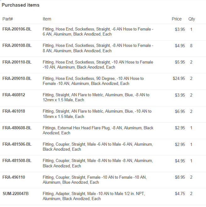

Fittings ordered
Still need to order the y block, filters, pumps, rails and the FPR.
