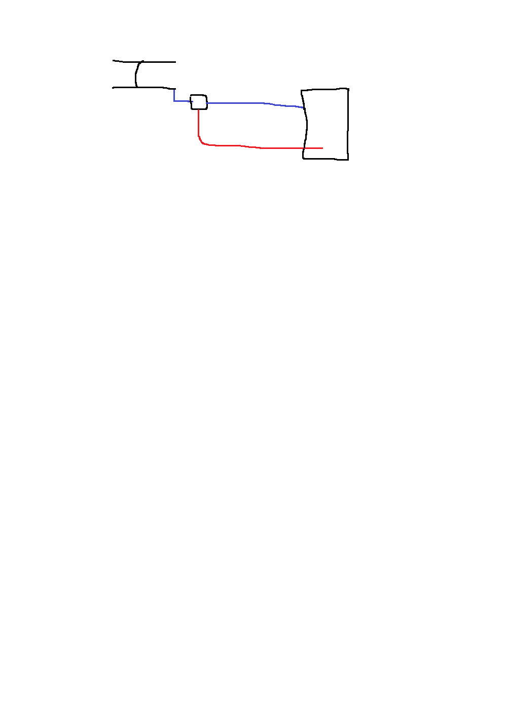

If I use a aftermarket FPR I will use the stock returnless fuel rail that I have now. So I will need to run a line form the pump to the fpr, then to the rail. and have the return either go to the stock return or run a -6 line back to the tank.

Ok gotcha, ya you could use the factory feed line as the return, I've seen that done plenty of times. One thing tho, if you plan on goin to a return style system youre gonna need different rails. There was a thread in here somewhere where they were debating the fpr before the rail on a returnless system and still running a return line. I drew a crappy pic to explain, blue is feed red is return.

The stock fuel rail has the FPR on the rail. Im now using the vett filter to regulate and return the fuel and it is before the rails.

Oh ya just looked at your sig thought the truck was newer for some reason. Keep us posted.
