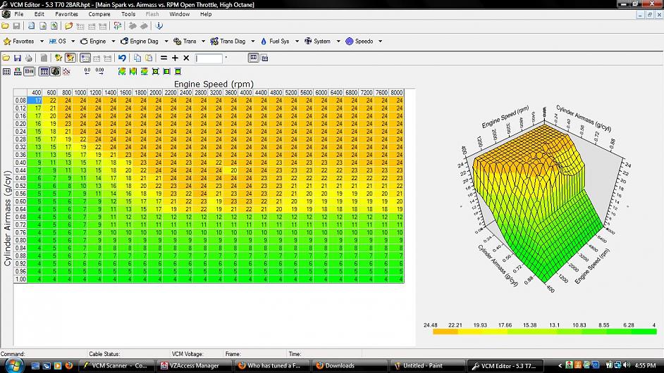

how much timing are you running..

his file shows between 5-9* at WOT

24* is the highest across the whole table.... starting at .68gcyl 12* tapering to 4* at 1gcyl
it should be plenty low....
I know it looks a little butchered up... but thats an attempt to get rid of the KR
