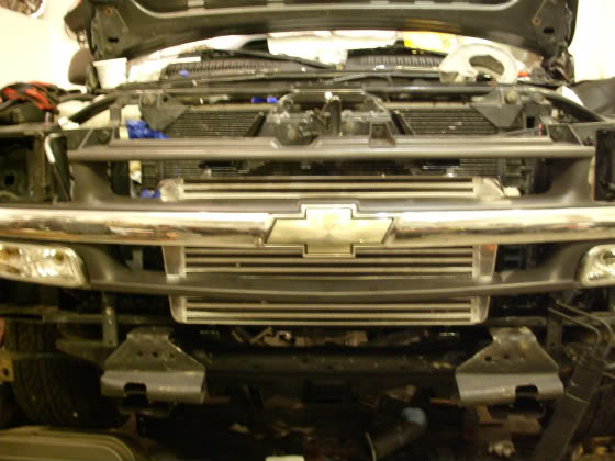

About the same i/c as Atomic. 4" thick, 30x12, 3" in/out.
I'm going to run this cut all the way out so it blends in. Then I'll color-match the grille.
Looks good! Did you have to cut the hoot latch support to get it to fit like this?
Old Feb 13, 2012 | 09:08 PM
Beatdown Z's Avatar
Laid Back
iTrader: (18)
Posts: 2,389
Likes: 10
From: Newark, DE
Yea, if you look in the first pic, you can see how it sits under the cut support, like Atomic's. You can also see the two L shaped pieces i made that tie it into the support. There's also two tabs I bolted on to the bottom of the core support to bolt the intercooler too.
