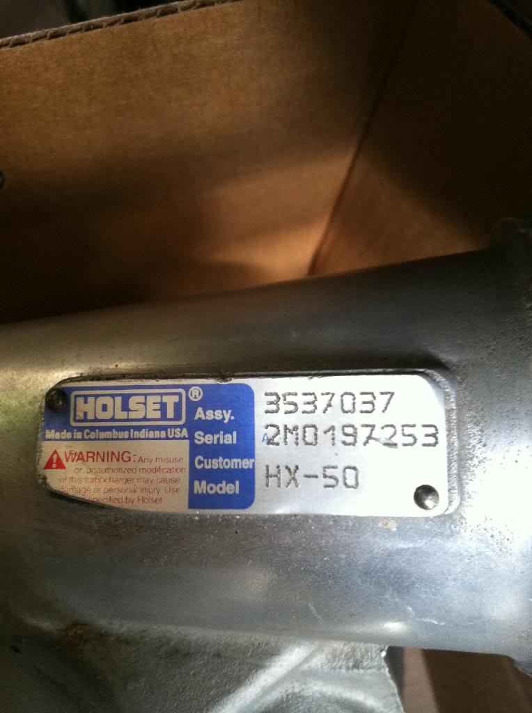

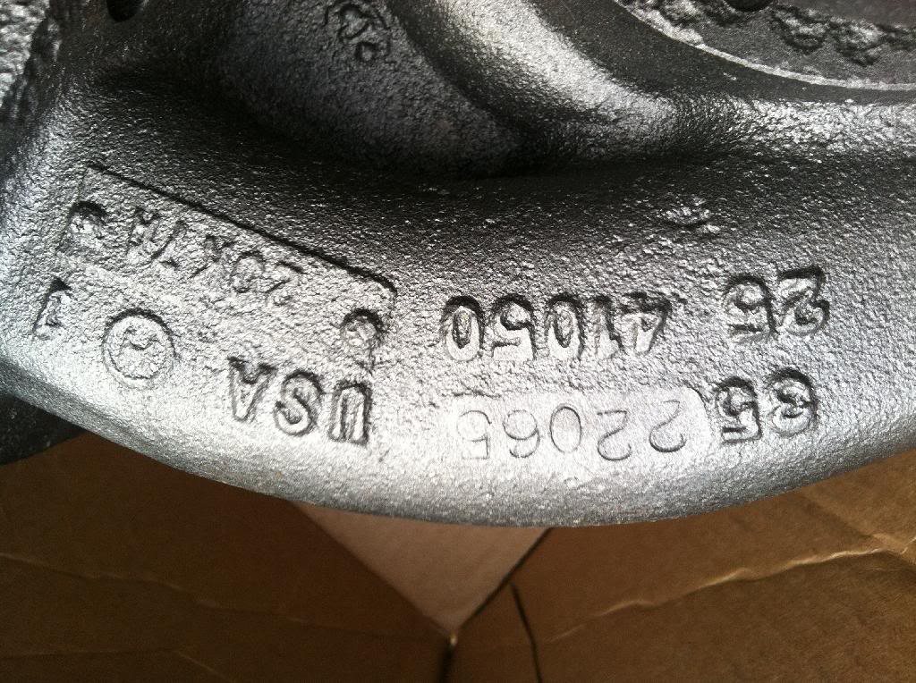

What are the specs of this turbo?

I measured (roughly) the inlet at about 67mm and exhaust outlet at 78mm

Nobody has any insight on holset turbos?
I have a buddy that aborted his fox body turbo project, has this freshly rebuilt HX-50 holset, three J-bends,and three V-band clamps. He will sell the "sloppy turbo starter kit" for $300. Is this a worthwhile deal?
I would like to put this on a 5.3, flipped manifold, non-intercooled, meth injected setup.
Is this turbo remotely sized "properly" for a 5.3?

Page 9 is the compressor map.
http://www.cumminsturbotechnologies....pring_2013.pdf

Little more info...
Our Turbos -
"With HX50 compressor wheel (64mm inducer, 93mm exducer) and HX50 turbine wheels (86mm inducer, 72mm exducer),"

So that map is all crazy with the x & y access. I mapped a borg warner s300 with a similar size compressor and turbine.
Looks like it'll run out of air around 5500 rpm. I was pretty conservative with the VE. If the VE is higher it'll run out sooner.

So I think that for $300 for the turbo, piping, and v-band clamps, I will pick this up. I can always upgrade to a BW later.

Yeah, that's a good deal.
