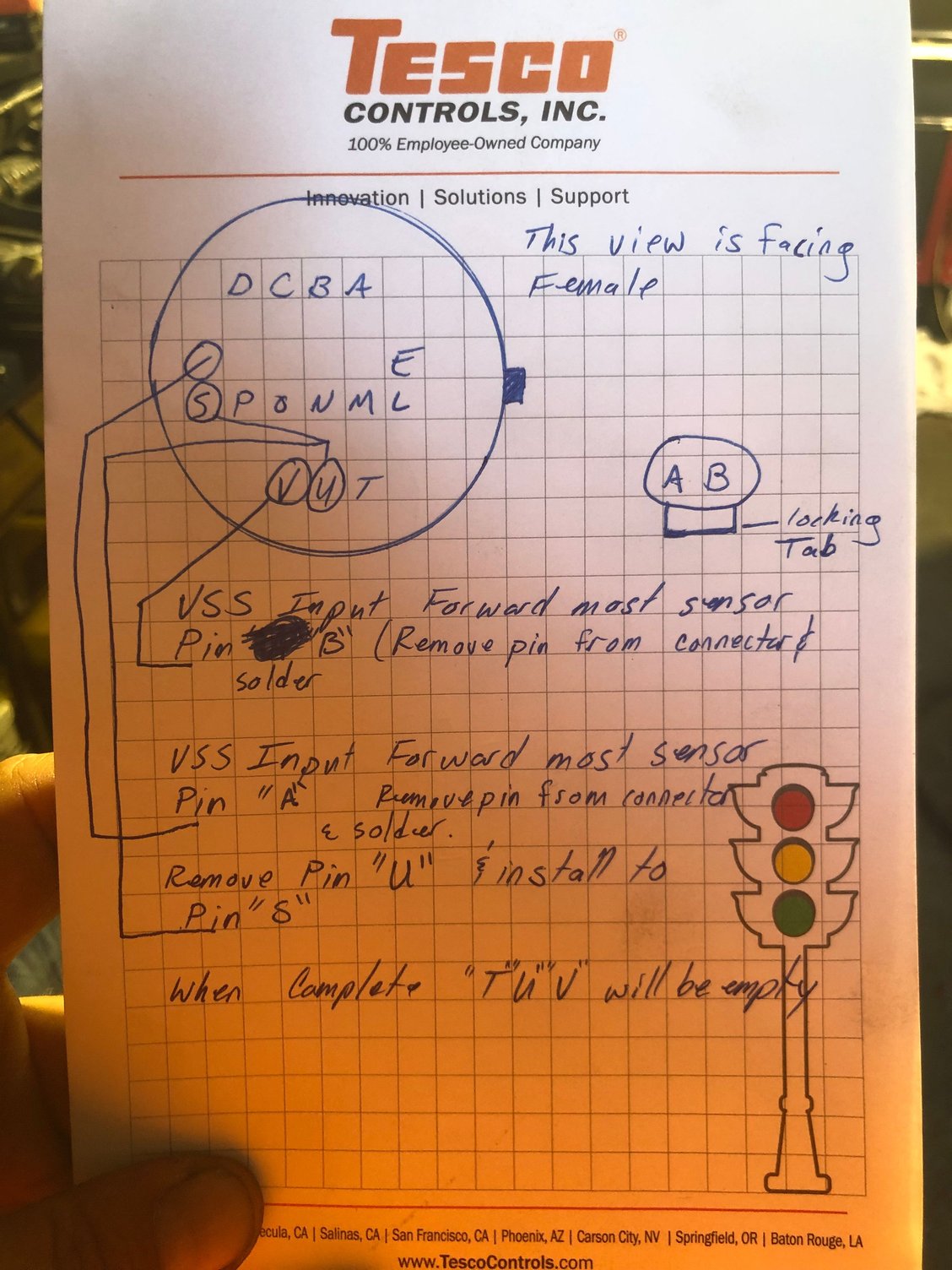

Originally Posted by StreetSmasher
speed engineering is the crossmember I used. I had to cut and reweld mine 1” further back.
email them to make sure it’s the NNBS one.
PM me, I can send the pin out to do yourself on the TCM and round plug. Then buy a new VSS connector and splice in.
mom an electrician. Took me about an hour. Average guy can probably do the same.
I never asked compatibility in years. Just told the builder what year truck I had.
mall in all, a case of beer and a days worth of work.
