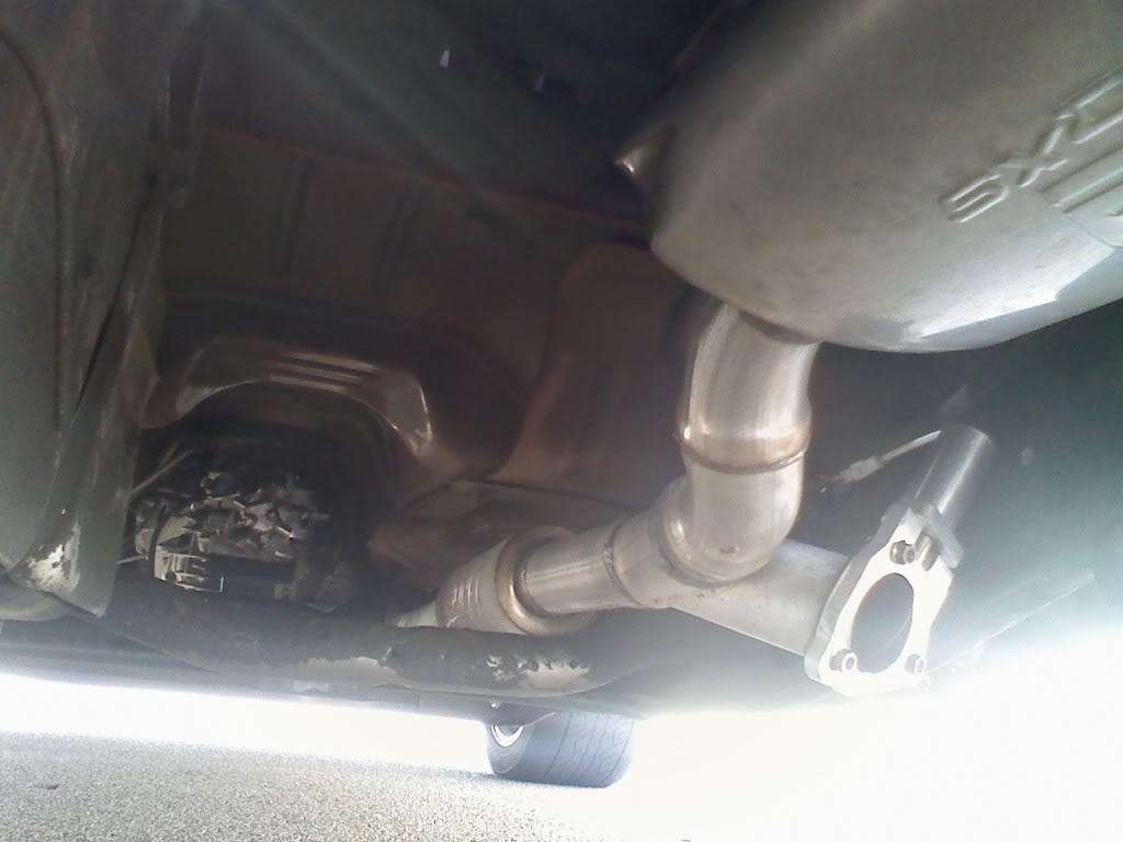

Here's one way to do two mufflers. This is a picture from my stock DriveShaft removal at 100MPH+. Anyways, you should do a cutout, there's going to be some days you'll want a little extra sound... Good to have the option. What brand mufflers you going with?

Im gonna go with magnaflow, and yea gonna have a Ecutout.
What brand cutout are you running on your truck?
I see your DS didnt like your borla too much

It's a Summit-Racing cutout and don't get it. I'm on my second one and I still have issues. It closes on long WOT pulls. If I leave it on at the track, it will be 75% closed at the end of the pass. It's because of the angle of exhaust hitting it forces the valve closed. Garbage.
Yeah the Borla took one for the team on keep the DS going out the rear and not taking out a rim/truck/me.

it faired quite well taking that into account.
