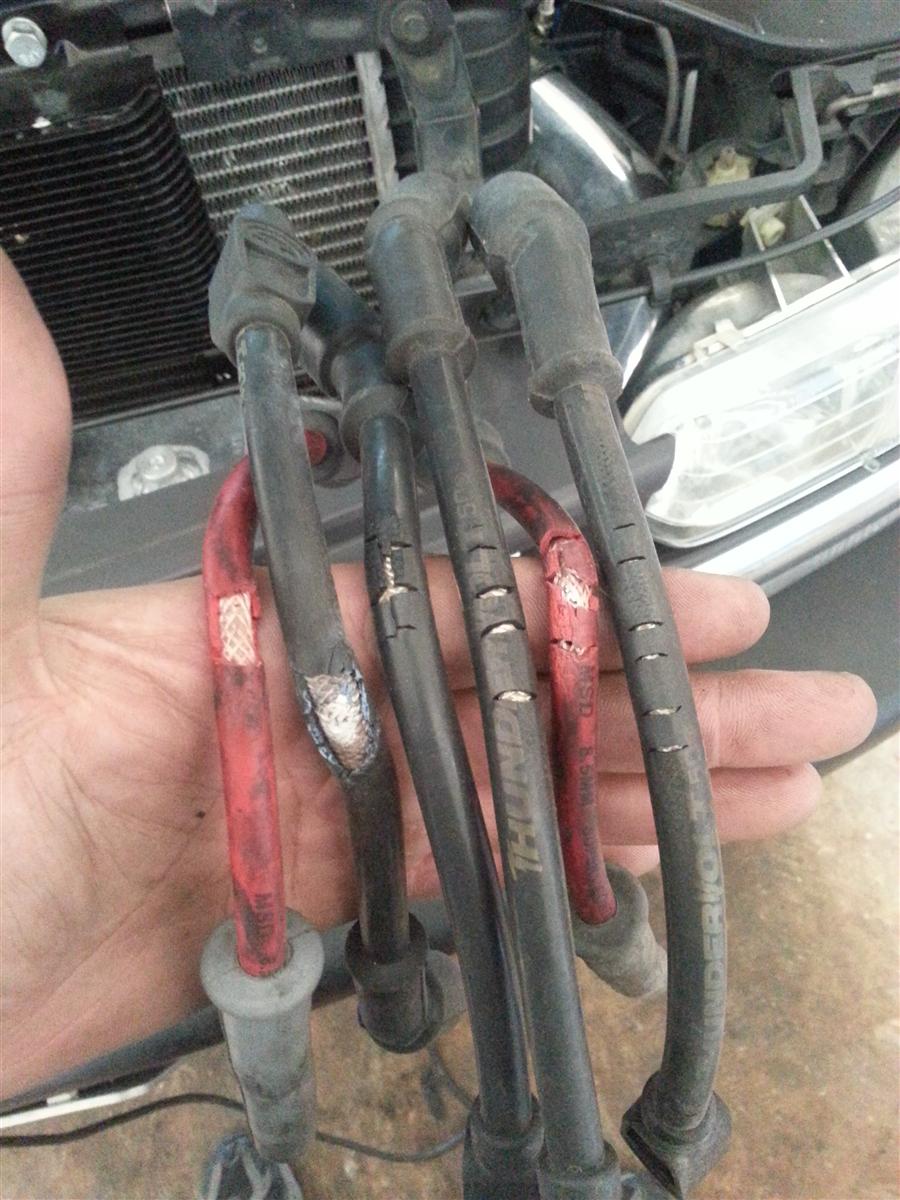

Move the wires as far away as you can. Even with heat wrap they will eventually melt.
I learned this lesson the hard way...

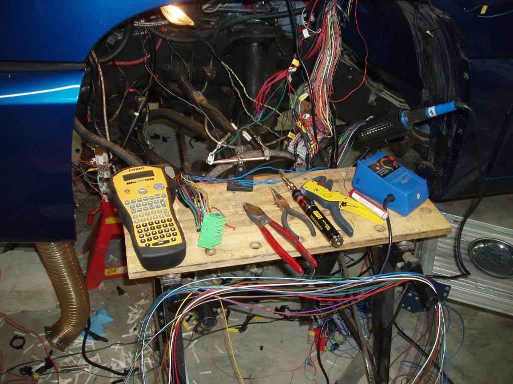

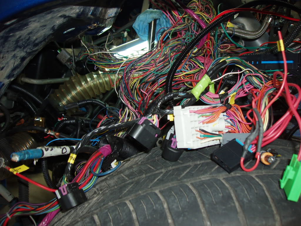

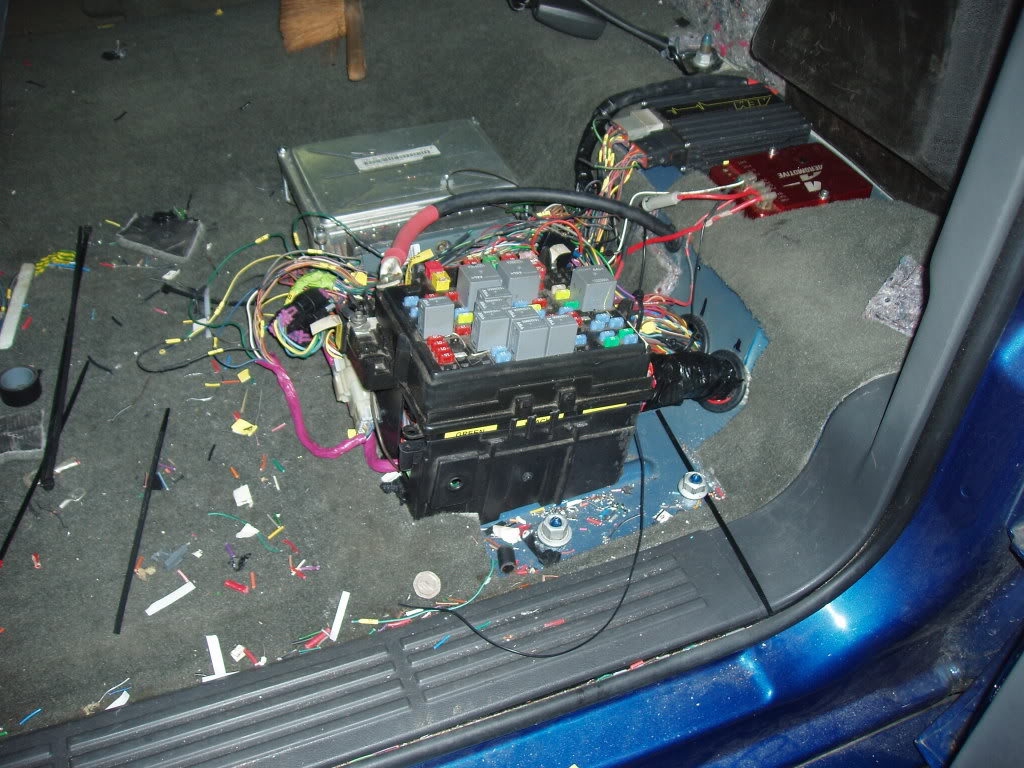

I moved my fuse box and pcm into the rear of the cab under the rear seat. Took a long time to do it though.

Dam that's awesome. Any problems after the move? Did you just add a bunch of the same color wire between the two points and solder the connections? Thanks

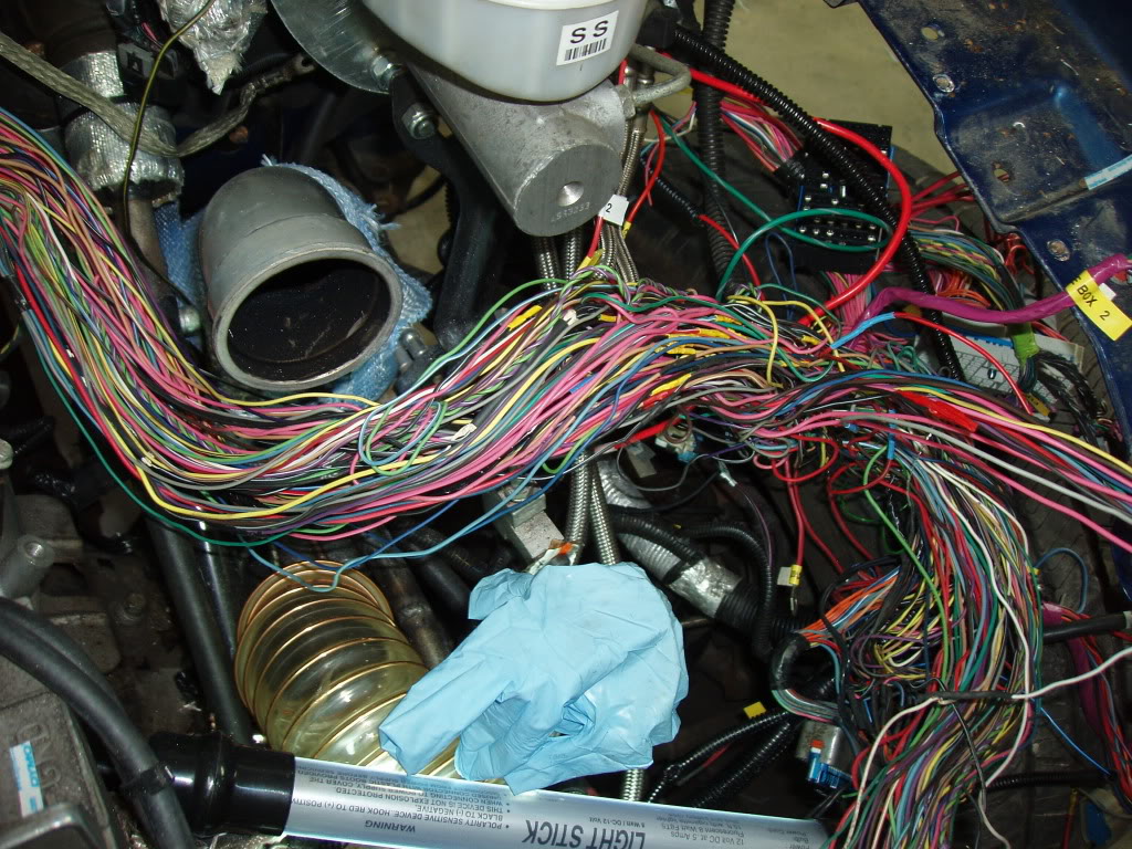

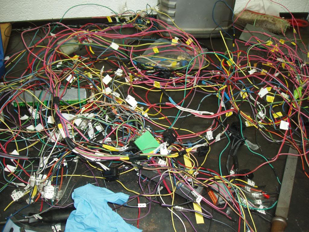

Thanks, only problems I had was I missed a couple of grounds for the lights,I figured I got lucky considering the amount wires.
yeah I just added a bunch of wires labeled them and solder them up also used heat shrink with glue in it to make sure every joint was good and water tight.One problem I had when I first started was the white labels in the last picture weren't very sticky and some fell off which meant I had to trace those wires back, once I got the Dymo label machine everything was fine.

It's a slow time consuming job but I am pleased with the end results.
