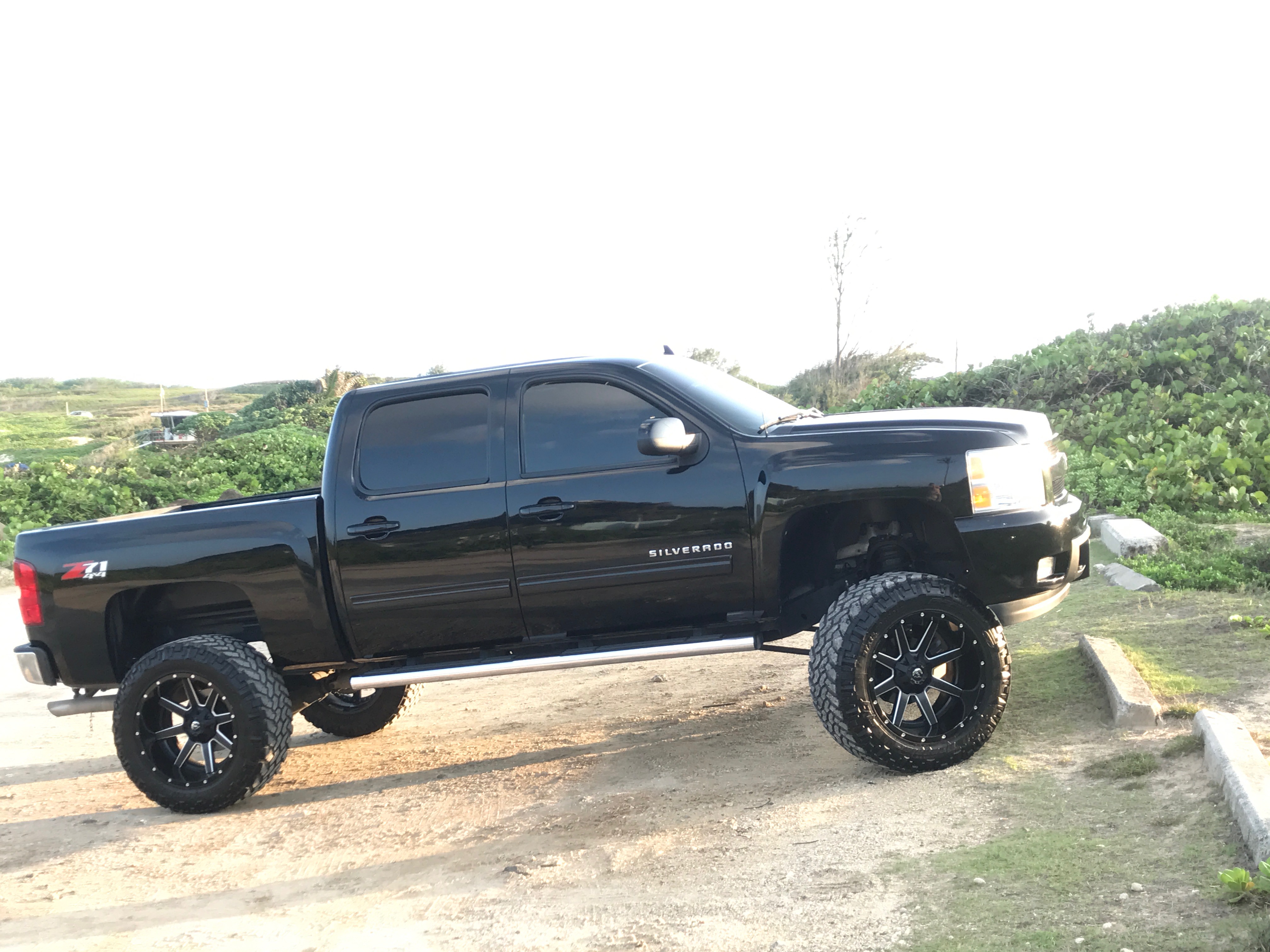

Im looking to put a turbo on my 2011 Silverado, what all do I need to do in order to turbo it?

Lots of readings for sure.
A turbo kit, large fuel injectors (like 70lb/hr or higher depending on power wanted), fuel pump (again depending on power level wanted, stock flex fuel pumps are good for around 550whp give or take), built driveshaft, new rear locker as the G80 will explode. 2-3 bar MAP sensor, wideband and tons of other odds and ends.
Take some time and research this stuff a little and you'll figure most of it out.

Okay thanks, the driveline of my truck is of a 2500 but its just got the 6.2. So I got the 4L80 tranny and bigger drive shaft, transfer case, and 14 bolt Rear end

a turbo kit from trick and 60lb or higher lb injectors. That will get you off to a killer start. you wont make killer power because of the big wheels and tires but it'll def wake up and you'll love the turbo sound.
