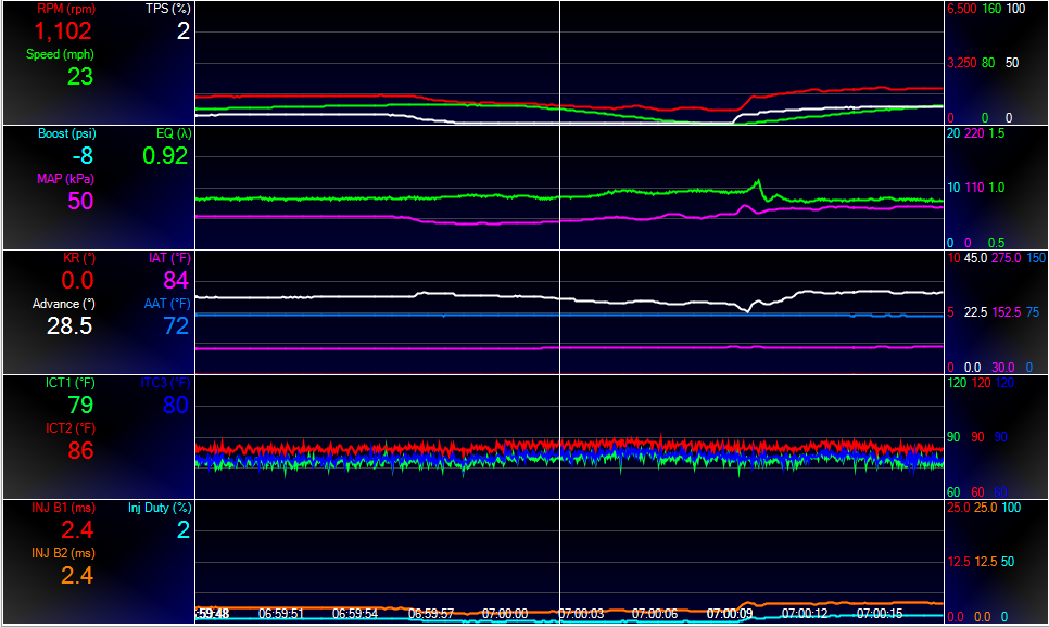

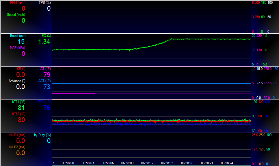

Here's the data...
Cold pre-start...
Right after cold start in cruise...
End of 15 minute stop and go cruise...

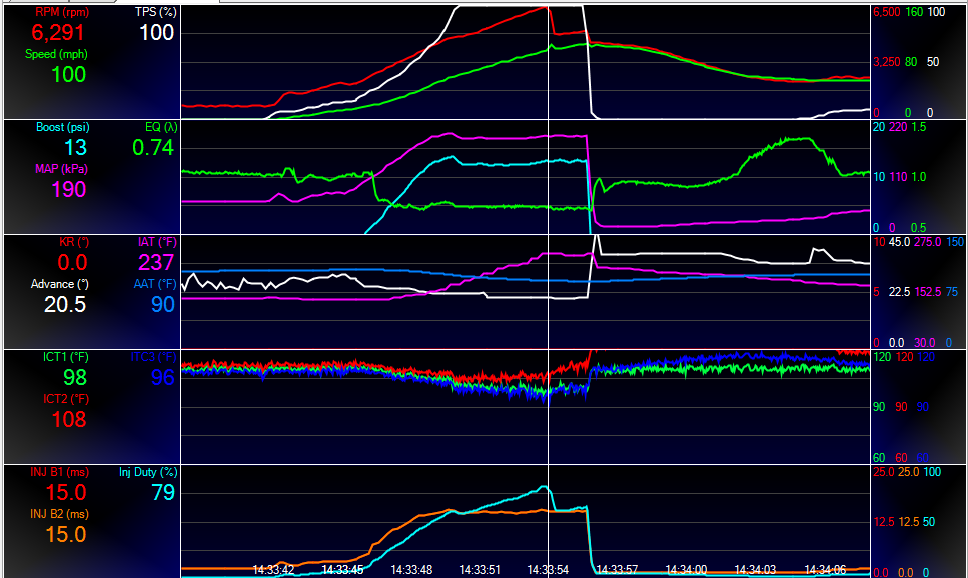

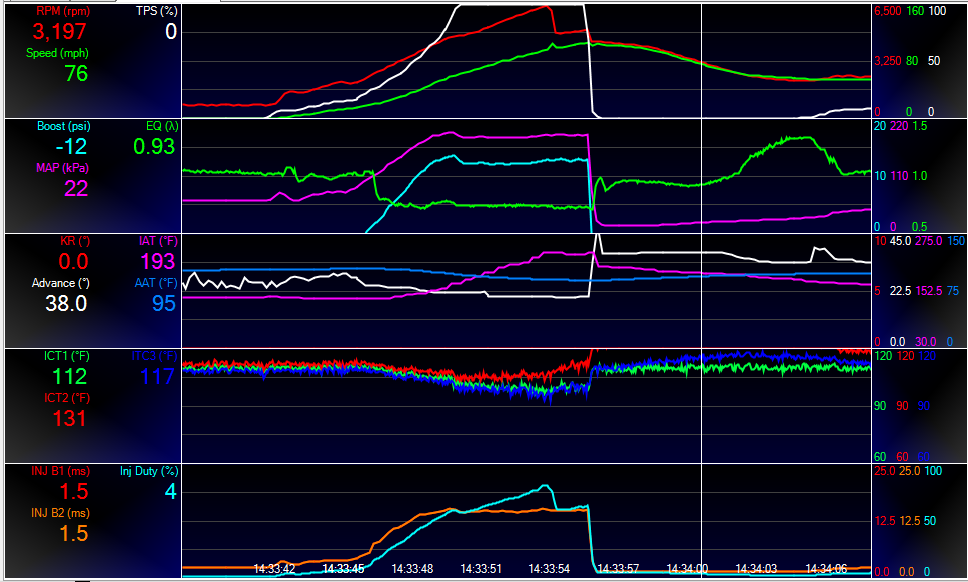

Now for the really interesting part. This is after about 15 minutes of stop and go in boost. Notice how all three temps fall when it goes in boost before the HEX in starts to rise. It does this on every boost transition. If the boost lasts for more than a few seconds the IC out/HEX in starts to rise then as soon as it goes out of boost there is a sharp up-tick of all three temps. Both HEX temps continue to rise from this point for about 3 seconds till they start dropping.
Graph cursor in boost region...
Post-boost at peak IC out/HEX in temp...
I do have a Caspers V-boost that bumps alternator voltage 2.2V at 70% throttle so that could account for the slight decrease right at 90% throttle and the sharp increase at throttle close due to increased/decreased pump speed.
