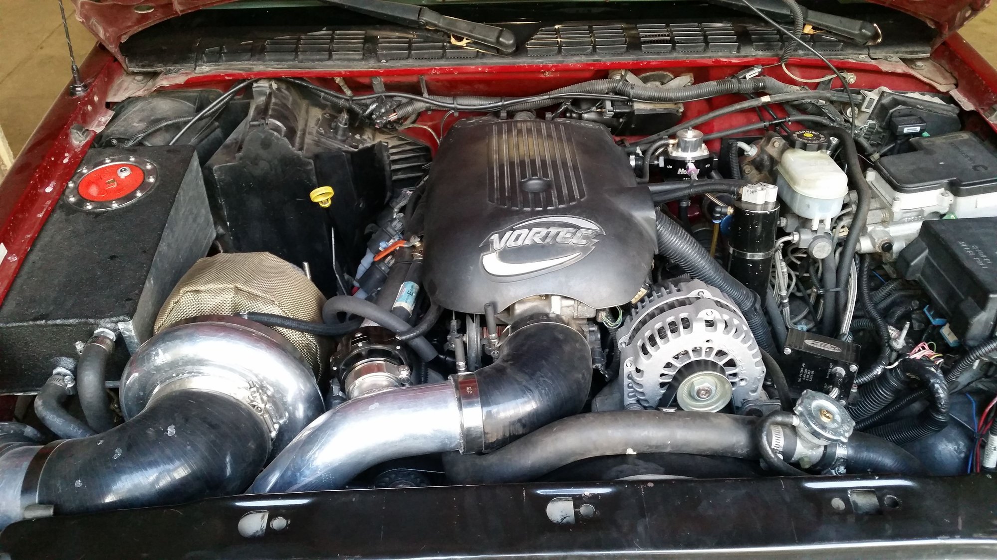

I only run A/W systems. They have their pros and cons like most systems do.
I have learned a lot with My particular set up, its very simple yet very effective. I have run it in a towing application with a 5.3, T70 and 10 lbs of boost, and now slightly modded in my current set up at 1k hp. I have a GLOWSHIFT brand dual sweep temperature sensor on my intercooler. It measures the IAT INLET and OUTLET of the Intercooler. Its AMAZING at how much the intercooler can drop the IAT's I have heard measuring the water temp works well too, but IMO thats not what we are concerned with, its the IAT's
I have a smaller Intercooler, its the Frozen boost 600hp core, in and out on the same side. I have learned that the Heat exchanger, the pump, the intercooler dont do squat unless you have good water CAPACITY. My current holds 3 gallons and works extremely well. These temp readings are with the HPscanner with the IAT right behind the throttle Body. 90 degrees ambient and I have seen at most 170 degree IAT. 70 degrees ambient and its around 130 ish. 50 degrees out and it maybe 110. That is at the top of a quarter mile pull. With a bigger Intercooler I am sure it would be better, but like most of you with space limitiations, just UP the system Capacity. You need a good pump, too slow and too much heat transfer, then the HEX cant shed enough of the heat. Get the biggest HEX you can fit, or a smaller one with a puller fan. The fan is the key. It makes it so much better. I run a 14 inch puller fan. When I am done with a pull, I shut the engine off, let the system work, and it pulls it right down to Ambient temperature or a few degrees less. Its ready for another pull then. I tried a bigger crazy high flow fan and didn't see a big enough difference to justify it. The new thing now is with an A/W system, under normal driving you shut it off. You only turn it on when you do a pull or put it on a hobbs switch. If you had an ice tank this could work well with adding ice, it wouldnt circulate and melt the ice instantly. I am going to try the on off set up next year, I can report back. Under normal driving, My intercooler inlet and outlet are 20 degrees different. When the amnient drops a bit I can get lower than ambient temperatures. at 30 -40 degrees out I have seen the Intercooler Frost up on the outside. It makes BIG power then. LOL.
I have a Custom tank that's got 4 layers of Bedliner to Insulate it, The tank holds 2.5 gallons. I have a big RULE bilge pump IN the tank, from the tank, it pumps it right the the Intercooler. If you want to run ice, then the IC gets the cold water RIGHT away. from the IC it goes to the top of the HEX then the bottom of the HEX it goes all the way up to the Tank and just dumps ABOVE the water line.
BTW I have an Aftermarket Honda civic aluminum Radiator (2 core) that is my Heat exchanger with a 14 inch puller fan behind it. You can be stopped and the system will cool vs a system with no fan. HUGE benefit to add a HEX fan.
Any questions? Ask away.
