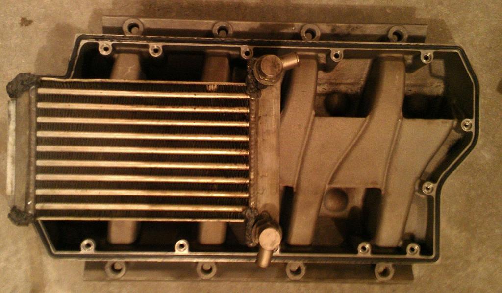

I'm no engineer, but if you could check the out flowing coolant temp vs the IAT and see how it changes during an increased flow, you could determine if the higher flow is beneficial. I think the key is a larger intercooler volume. I was going to make a large intercooler for my Maggie years ago, but like many things in life I never fini...
Old Oct 19, 2016 | 09:11 PM
  #36
Gadgetized's Avatar
Joined: Jan 2010
Posts: 3,095
From: Rochester, NY
Here is an original Maggie intercooler.
Here is what I never finished.

I built a larger core 2x different blowers in the past for he Maggie's. Never got feed back on them.
True single pass is the only way to go for water to air. That dual pass stuff just doesnt fly well on higher boost.

Trick I never understood what you mean by single pass? The intercoolers I have seen you make have the inlet and outlet on the same side. How could you possibly have a single pass in that scenario?

Water passes through the entire core 1 time. I really don't go into huge details how.
I tried to get into the Maggie world with bigger cores years back. But the market just wouldn't help the cause. . It's not cheap building a/w cores to fit in the area be thicker and still bolt up like the stockers do.

I'm still confused though...
How is that single pass? I love everything else you did with it. I love that it flows significantly more water. I wish it was even thicker to be honest... I feel that's the most important aspect, but otherwise I love it.
