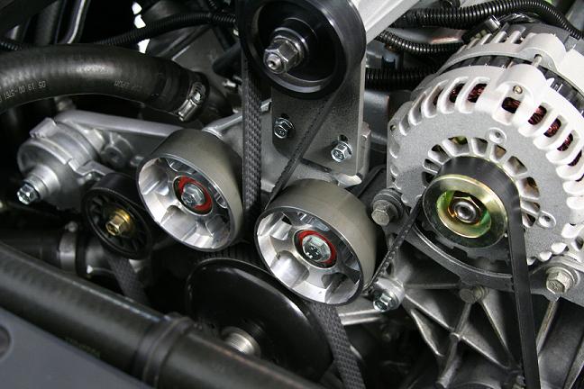

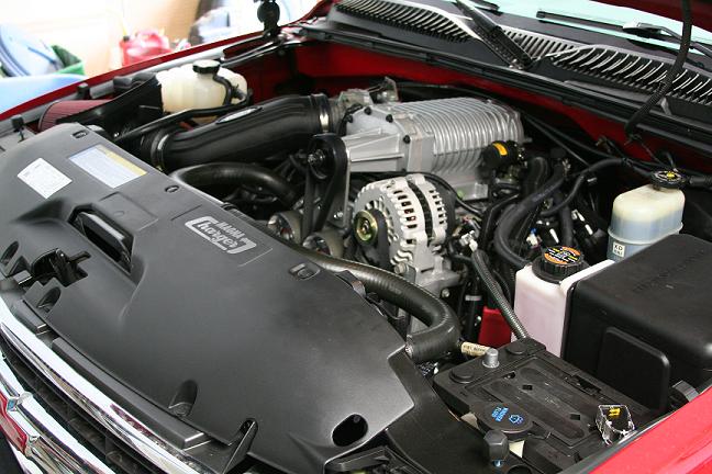

First of all I need to get those pictures for Holty, I will have them tomorrow. Sorry about that. I honestly dont know what fixed the boost problem, I am just glad it is fixed. It kind of bugs me because I wish I new what the problem was and what I did to fix it.

Here are the pictures that you asked for.
Originally Posted by Holty
sorry for the hijacking here but do you have any pics of the metco pulleys?
